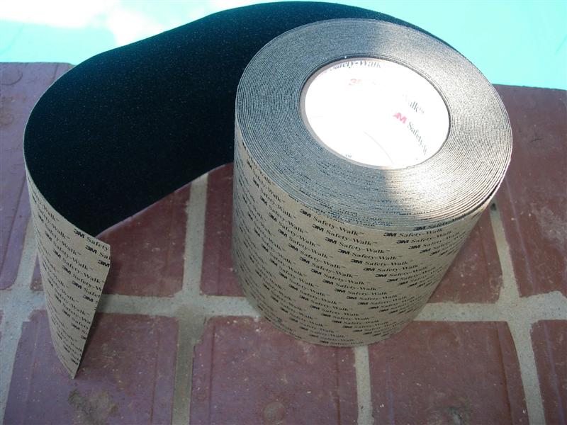

Re: Trailer upgrade
Get some of this stuff.
Dear as poison but really good!
Decktread (Medium).jpg (79.72 KiB) Viewed 628 times
grip to die for
Re: Trailer upgrade
But no good on checkerplate :?
Re: Trailer upgrade
robracer wrote:But no good on checkerplate :?
No I wouldn't think so ;)
