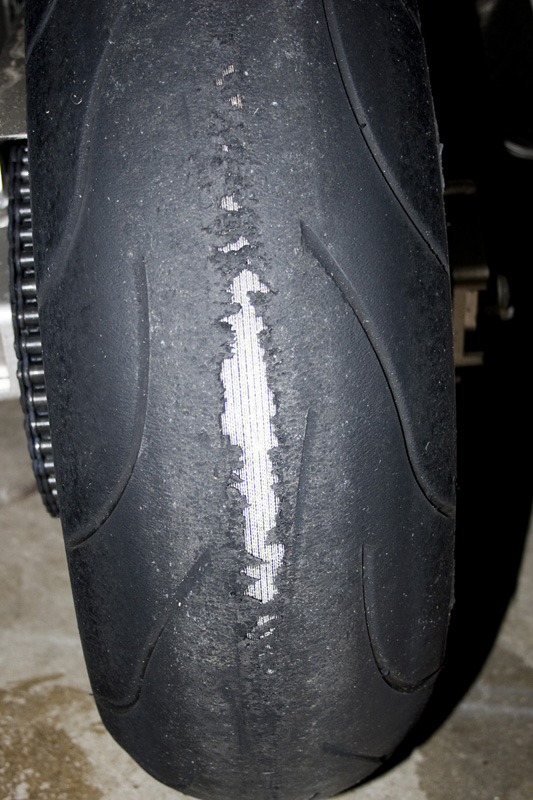

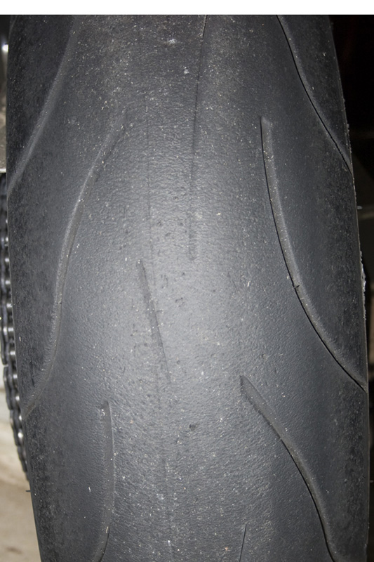

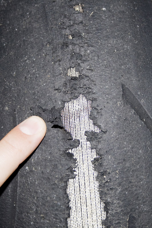

So, there I was just minding me own business when ol mate pulls up behind me and says "Mate ya tyre Farked!" Imagine my suprise..."What?", I said..."Yeah clean throught to the Braid"...So, only 30K's from home I decided best not worry me'self; they were ok this mornin' before I went up the putty; best leave it till I get home. Anyway, he was right. Not so bad all the way round, but prodominantly in only one section...See pics. Anyone seen this type of wear before? Looks like it's delaminating from the carkas. No burnouts ever done on this tyre and while it is in pretty bad shape in general, there is still rubber on the majoity. Is this normal? Cos if it is then I think all of Hoffy's propaganda don't mean shit, lol. Any thoughts.

that's not uneven wear mate - its just that your tyre is well and truly rooted !!!
Mick C did this to a Pirelli a couple of years ago on his mates ZX14 - the tyre was looking close to replacement before the trip, but one *really* hard strop down near Halls Gap saw the tyre down to the belts in just *one* tiny little spot.
All tyres do this when you get to this point - they never start to show the belts all around the circumference of the tyre at exactly the same time, they start at one spot and just begin to wear out along the circumference from there.....

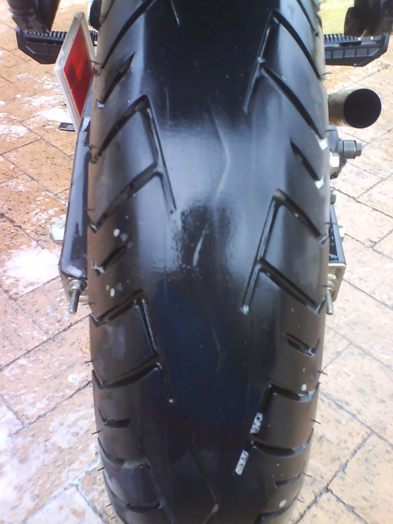

Here is a picture of the Pirelli that Mick trashed - it did last all the way back to Canberra from Halls Gap, this shot was taken when it finally made it home.....
Re: Uneven Tyre Wear on Pilot Power
Yep, once you're getting towards the end of the tyre it can dissappear a lot quicker than you think and there's not really a lot of rubber left once you've got to the bottom of the tread. It's also usually pretty uneven like you got on the Michelin.
The tyre above didn't look too bad when we left HG, I thought it had another couple of thousand in it, but by Deniliquin it was already starting to show through to the belts. I had a good look at it when they pulled it off and that gap in the middle of the belts where I'd worn through them had just the lining rubber on the inside of the tyre left....I'd say it was less than 1mm thick, that was it
