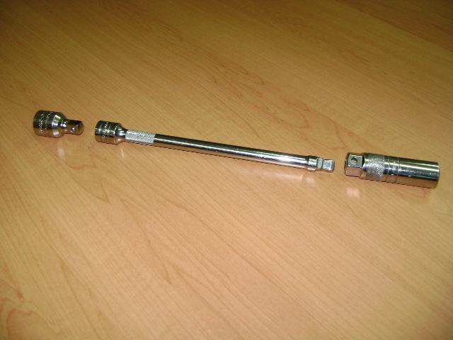

Best Investment I ever made: from Snap-on
1/4" drive Thin wall 5/8 plug socket 1/4" extension bar 1/2" to 1/4" socket converter
Re: Spark Plug GPZ1000 Removal
The plug socket has a rubber sleeve inside that squeezes the plug & holds it for removal & insertion ;)
