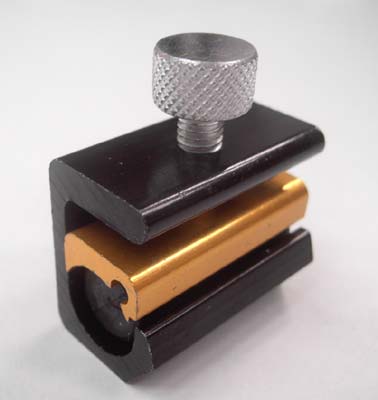

You should lube the entire cable if you haven't already, Suggest pulling off the top lever hold the cable up & dribble WD40 into the cable sleeve, enough to come out the other end.
Or use a cable oiler like this :
These are available at accessories stores & are quite cheep & do the perfect job of keeping your cables moving, they are dead simple to use.
Have you had the tank off to see if the cable is the problem?
