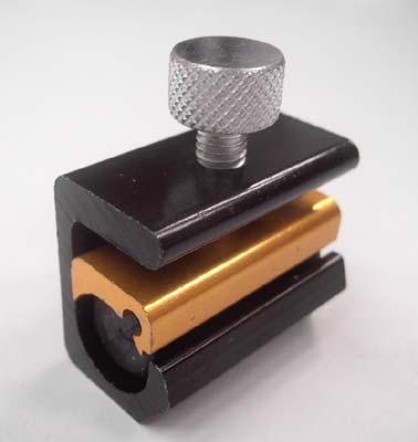

Or use a cable oiler like this :
These are available at accessories stores & are quite cheep & do the perfect job of keeping your cables moving, they are dead simple to use.
