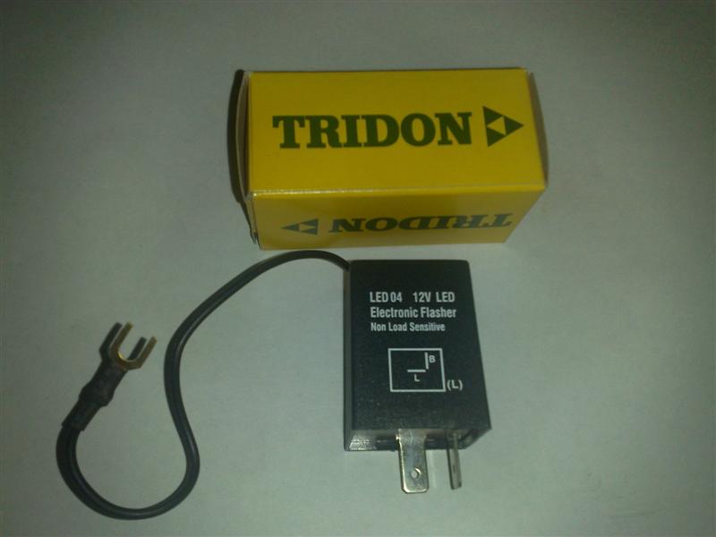

Re: Problems - PROTON FLUSH MOUNT TURN SIGNALS
Ive just changed my rear indicators to LED,s and now they all seem to flash slower than usual
any ideas how to bring them up to speed?
Get one of these ( any auto-electrician/Superthief/Autobarn/Pep's) ......
- 08112010331 (Medium).jpg (42.39 KiB) Viewed 5168 times
sweet thanks
