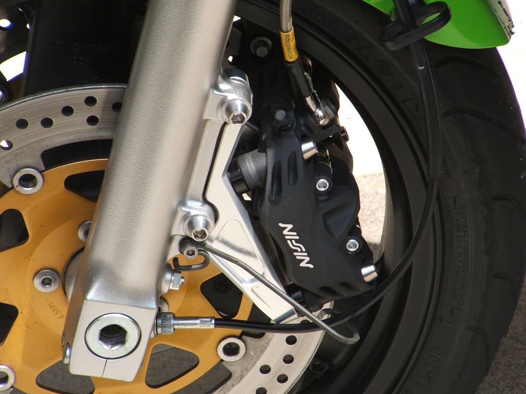

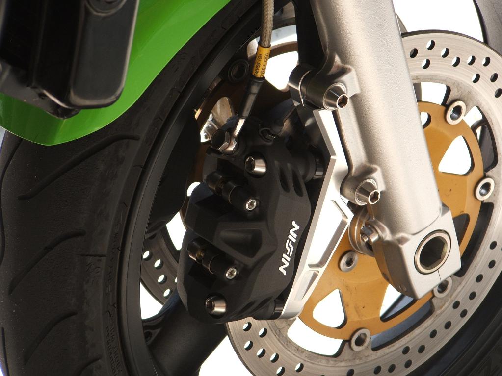

I fitted radial calipers off an '09 ZX6R to the REX today. You need adaptors that are on eBay (Taiwan) to make it work. I was able to use the Goodrich braided lines and stock m/c. I only did about 40kms after fitting but the result is very strong brakes with progressive feel. I was worried that they might have been on / off but they're not. However, even with 1 or 2 fingers gently caressing (source Mills & Boon) it's like hitting a brick wall :D .
I bought the '09 ZX6R calipers brand new from the U.S. (US$250 shipped) and the adaptors from Taiwan (US$155 shipped), so for less than A$500 it's a huge improvement.
Changeover was straight forward (30 mins) and I bled the brakes by myself (like getting an octopus into a string vest) which took me about 90mins.
Worthwhile upgrade to the stock brakes. The calipers came with stock Kwaka pads and lines and I'll use the pads for a while. I only did ~40kms today on the new pads so when they bed in they may be better again. At some stage I'll change to EBC HH and that may give even more improvement.
All in all, a very happy camper :kuda:
TC

Very nice. Can you post a link to the mob in Taiwan you got the adapters from? I'm going to have a look for some for a 9 ;)

dave#3 wrote:Very nice. Can you post a link to the mob in Taiwan you got the adapters from? I'm going to have a look for some for a 9 ;)
It's not letting me post the url, but type either of these in and you should get there. The vender is a guy called Leslie and he is very helpful -
- ZRX1100 ZRX1200 ZRX Calipers Bracket Tokico 108mm
- Item Id: 320465280921
Cheers,
TC
