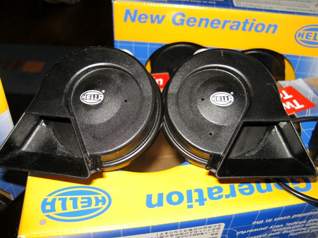

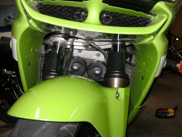

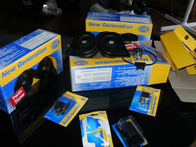

The first thing we did was went shopping for some new horns. These should do the trick:
Tony made a little bracket out of steel that bolts to the top radiator mounts, they don't interrupt too much airflow and they should clear the mudguard on full compression...
One little telltale wire to the relay is the only sign (other than the big fuck off horns) that anything has changed:
Next time you see me ask me for a toot, or if there's popular demand I'll whack something on tubeface. Despite the filenames they're not air horns just little elecrtic jobbies, the only thing in the box is the two horns.
Honk honk...
Honk honk...

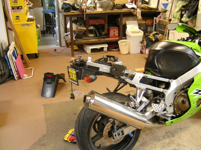

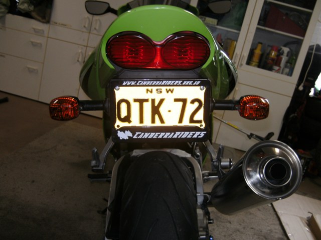

The next thing that had to go was the 'orrible rear fender, we picked up a second hand one locally and set about making the rear end look cleaner:
Muchos betteros...
Muchos betteros...

Re: My 9 - A work in progress...
Elimination looks great
.... for the horn replacement I have been told that ones out of beemers are the go
Honkety honk
Tidy work on the fender eliminator, much cleaner than the stock one.
If you want to pull the indicators in a bit closer in I seem to remember there was a way you could move the spacer onto the inside of the fender so it still looked stock but neater and could be reversed later on if you needed.

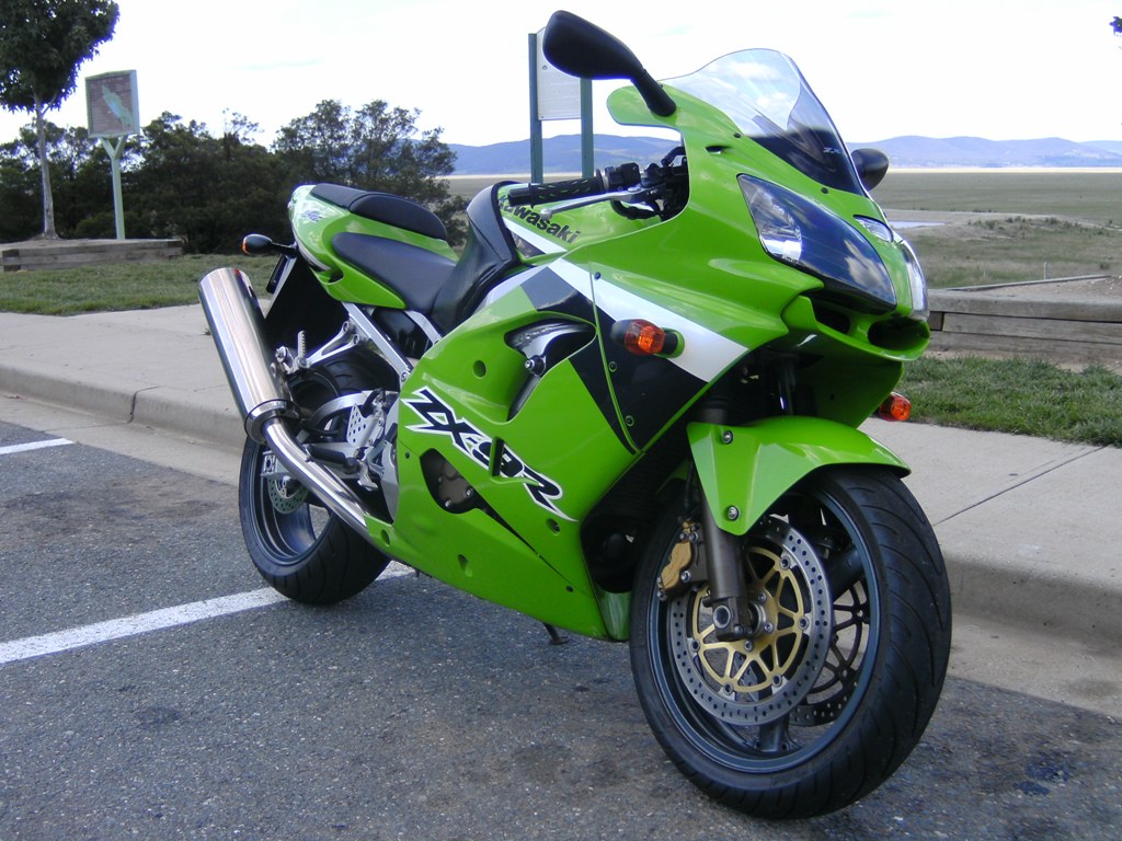

umm guys... dont mean to alarm you too much, but you're front wheel is either on backwards or they fitted the tyre the wrong way round...
Well spotted Pinchy, the tyre is indeed on backwards
The question is, have Bikebiz Granville just put it back on backwards after fitting the new tyre or has the tyre been fitted backwards on the rim? Have had a look and the cast writing is on the left on the rear wheel (the right side of the spokes are smooth) and on the right side on the front. Is the wheel reversible and they've just cocked up it when they put it back on?
Phone call on Monday could be a good idea me thinks.
- Six Addict
- Pinchy
- Posts: 6465
- Bike: Ducati
i think the wheel should have an arrow too, but it may not matter... the tyre should deffo not be ridden backwards
- robracer
- Posts: 15251
- Location: Port Macquarie
The directional arrow can be seen on the rim in the second Pic, towards the top front
