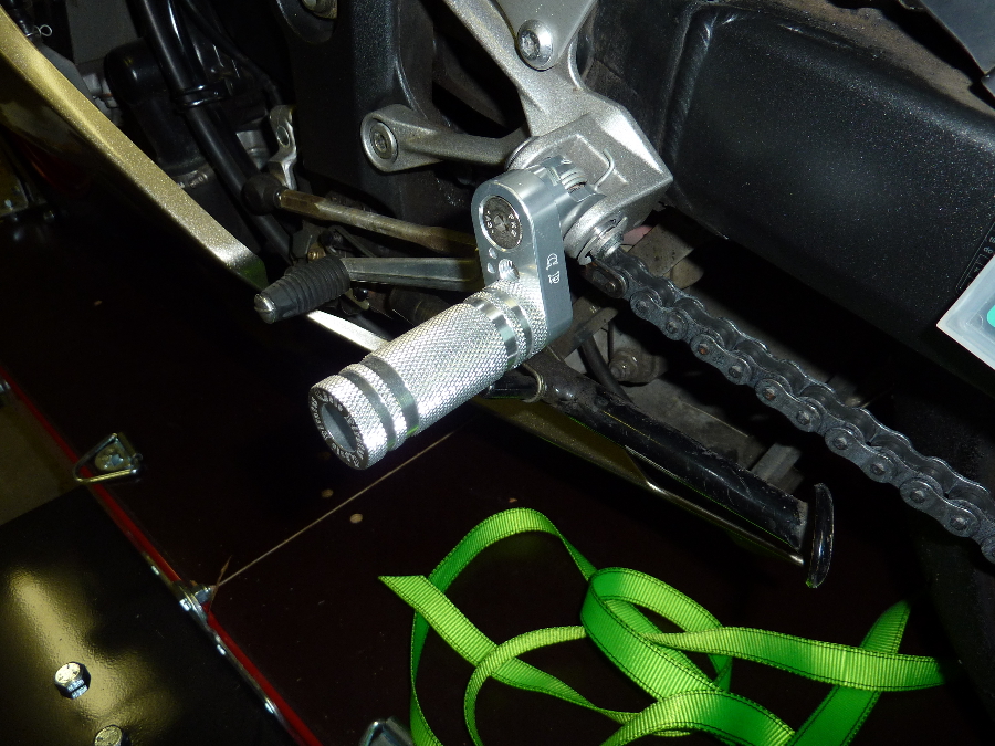

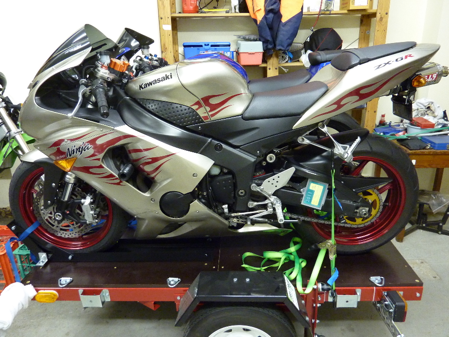

I have attached a few piccys of the bike post additions (based on a thread somewhere in this forum). Yoshi slip-on, PC-III, Hotbodies DB and hugger, GPR stearing dampner, T-Rex crash knobs, fender eliminator, EBC HH pads, and cycle pirates 360 degree adjustable footpegs. I am 193 cm and smashed my leg pretty badly a few years ago, so need a bit of extra leg room. At $100 or so from Indy Superbikes in the states, they are a cheaper option than rearsets.

Those pegs look great but you will loose corner clearance :o when my tracky was stock I ground the pegs a couple of times at EC... (hero knobs removed)

These pegs can rotate around the centre to give alot of adjustability back/up for the future. My right leg is maybe at 50% normal strength with a limited range of movement in my right knee, so I really need the extra room to be comfortable on the bike. As I get used to it and grind the pegs more and more, I will no doubt adjust them back and up. Being a gumby, I don't lean it over enough to get my knee down anyway :roll: .
