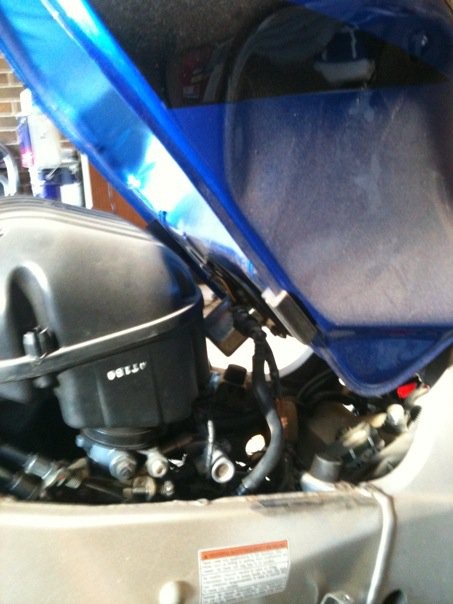

Hey guys, I have K1 GSXR as a track bike... I normally run it for a few mins every few weekends since I have not been getting the chance to get out (another child on the way, and havent got money for tires)...
4 weekends ago I went to start it, as I usually do... It usually starts fine, but this time no go...
I am guessing it is a fuel problem, since it does not fire at all... but it sounds like it wants to...
I figured, No worries, lift up the tank, pull the hose out and see if fuel comes out...
I wasnt expecting this (see pic below)... There is some sort of alien technology attached to the bottom of my fuel tank...
Anyone know how I can test fuel flow taking into account said alien device? (it has a very solid hose that comes out, it appears I may be able to unattach it, but I am guessing that the thing on the bottom of the tank is some sort of suction device and the engine would need to be running to pump it?)

thats the fuel pump. you need to disconnect the 'other' end of the fuel hose, turn on the key, and see if any fuel gets pumped out .

I don't know about your machine, but most Kawasaki's will only pump fuel for about 1/3 of a second when you turn on the key and don't resume pumping until you crank it over or it is running. So do not expect a solid flow of fuel with just the ignition on. You also stated that your bike has been sitting for awhile, the problem could be bad fuel. If your going to let any gasoline powered vehicle sit more than 3 or four weeks you need to put a fuel stabilizer in the gasoline, otherwise it turns to shit. If that is the case you will need to drain your tank and put in fresh fuel with some kind of injection cleaning additive. The smell of the gasoline will tell the tale. If it smells like varnish it's gone bad. You could also pull a plug after cranking and see if it's wet and at the same time check for spark. Go to the thread "zx2r cold starting problem" to see how to check for spark.

Yup, its bad fuel....
I just managed to get the fuel line off... turn the key and pumped out about 3 seconds of fuel.... Smells like a truck full of dirty socks mixed in with terps
I will drain what is left... How do I get rid of the stuff that is already in the engine? Is that even possible?
I was thinking of putting more fuel in with some sta-bil... and then running it... You reckon that will do the trick?

The best stuff to throw in the tank Stereo - when you fill the tank with new juice - is a bottle of injector cleaner (Wynns etc), and take if for a strop at the track. The old petrol 'in' the motor will last all of about 5 seconds once you get mobile.....Stereo wrote:.....I will drain what is left... How do I get rid of the stuff that is already in the engine? Is that even possible?
