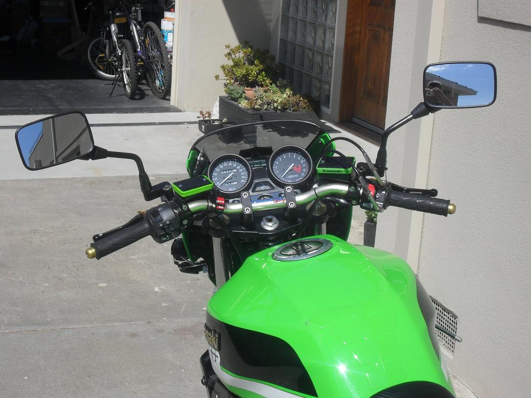

My order of preference is (1) drag bars (3) low rise (2) medium - I've had drag bars on the REX and you've just gotta flip the bar mounts 180' to clear the tank.
Great position with drags. I changed to Coerce low rise and am happy with them (they're close to your no 3). Only reason I changed was I prefer the look of the low rise. :roll:

I like the low rise bars!
piccie of Coerce low rise ....
Low Rise Bars
Low Rise Bars
Coerce bars on the bike

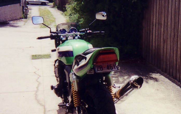

Drag bars on the 1100

I run the Coerce low comp too, same as TC....nice bars.
With the threaded bar end in the stock bars, they're not too hard to remove. I just carefully cut through the solder and they came out, there's not too much on there.... its just a threaded alloy plug.....
I re-used and welded them into my coerce bars to attach the bar end mirrors..
Hope that helps... :)
