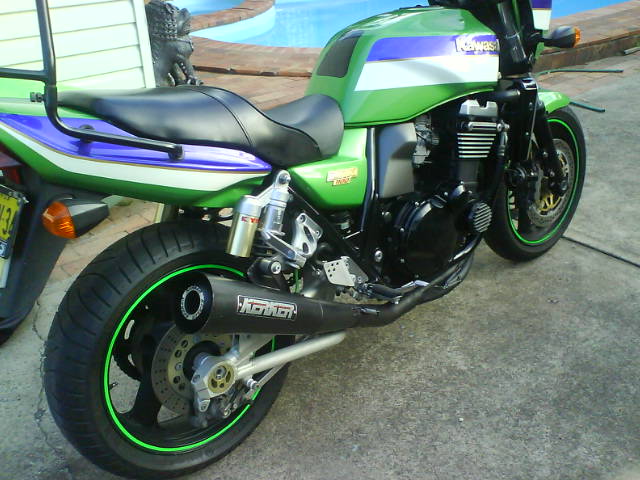

rooster
Posts: 2300
Re: tune up
Post by rooster »
You need a Kerker :D :D

rooster
Posts: 2300
Re: tune up
Post by rooster »
ezzazrx wrote:Where can I find one Rooster
http://www.jcmotors.com/p-9440-kerker-m ... 99-05.aspx
This is the link with dollar strong this is a good time and it is cheaper than when I got mine, bugger. Delivery no hassles.
They look and sound great, mines a race meg, some say it maybe a bit loud :shock:
