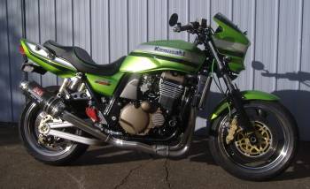

I've fitted a K&N filter to the Rex,and also cut the yoshi in half; i'm thinking I need to get the bike tuned up as she's burbling alot on the decel--- any thoughts apprieciated.

here is a bit to get started....'burbling' on the overun, could be a leak in the exhaust somewhere - sounds like the bike is running a tad lean, so you may need to lift the needles a notch or 2 to fix that.
Re: tune up
Posted: Mon May 10, 2010 6:49 pm
by s man
Fitting a K&N + cutting the muffler will lean out a carbed bike for sure.
You need to stick it on a dyno & get an AFR reading at 1/4, 1/2, 3/4, & full throttle, that will tell you which way to go with jetting, needle postion, & idle mixture.
If its burping at closed throttle it almost 100% certian to be lean at closed throttle.
This can all be fixed & the upshot is you will gain a heap of HP in the prosses..

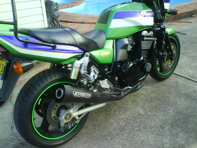

You need a Kerker :D :D

US ebay. JC Motors is a good place to start looking. There are heaps of big bike warehouses in the US that ship globally, and they all do it far better and quicker than any of the local suppliers - and far cheaper too.

ezzazrx wrote:Where can I find one Rooster
http://www.jcmotors.com/p-9440-kerker-m ... 99-05.aspx
This is the link with dollar strong this is a good time and it is cheaper than when I got mine, bugger. Delivery no hassles.
They look and sound great, mines a race meg, some say it maybe a bit loud :shock:
