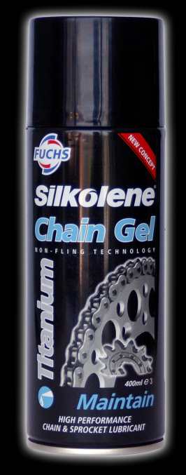

I Use this stuff & its available at some supa cheeep shops
Their Blurb:
Hyper-strong, PTFE boosted, super light gel that protects your chain, leaving it with a bright, white, ‘as new’ finish. Resists high speed fling-off while providing exceptional anti-wear performance on chains and sprockets. Contains special additives to give maximum corrosion resistance, even in the most severe weather conditions.

Experience has shown me that chain Lubes have come a long way, I grew up using Belray & could not fault it until the new formulas of chain lube became available. The stuff pictured above sprays on white so for a start you can see what you have covered when applying your lube :D I tend to also use the colour as a guide & that is when it goes black & starts attracting dirt I clean the chain & re apply....... about once a month. I use Kero for cleaning the chain... apply scrub wipe off then dry before the new lube goes on. Every 6 months I will use a can of chain cleaner to do a really thorough job, its too expensive to use all the time. Now for the sake of the cost of a can of chain lube once a year I would rather use it than not use it, the benefits... no rust, minimal noise, little chance of chain failure (it does happen). I don't know how often you use your bike but I knew a bloke that would keep his bike spotless but it got to a point where he became anal about it & would not ride the bike for fear of getting it dirty.... was a farkin waste of a good bike.
