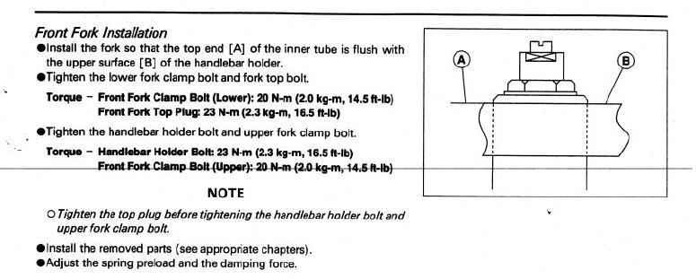

how far should the forks protrude through the top of the triple clamps?
is the stock set up with the fork tubes flush with the triple clamp?

Uh huh. Stock is flush with the clip-on.

thanks
i guess the suspension on the ranga isnt stock then
it has about an inch of fork tube showing

Are the clip-ons still on top of the triples?

yesdave#3 wrote:Are the clip-ons still on top of the triples?

Assuming it's got the standard forks in it, which it probably does, it's been dropped a fair way at the front. With the Ohlins in the rear (which is longer than stock) and the front dropped a long way it would certainly be pretty sharp to turn in
