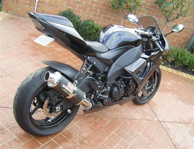

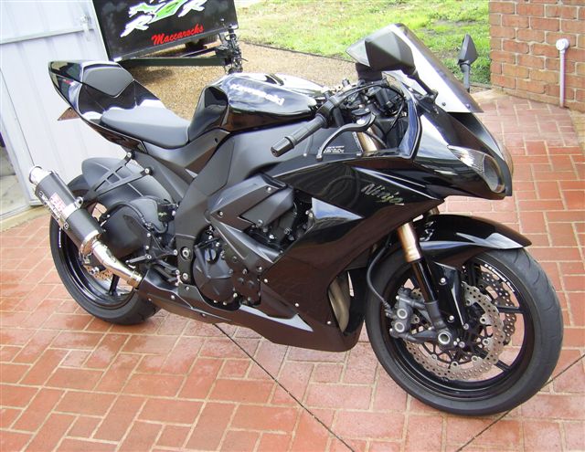

Stick a set of 09 ZX6 mirrors on it.. they look awesome..!!
Macca
Macca

where'd put your indicators?Maccarocks wrote:Stick a set of 09 ZX6 mirrors on it.. they look awesome..!!
Macca

I removed the parkers and rewired them so they became the indicators.. just replace the clear globes with amber ones.. they are only 5 watt, same as the parkers and I got them from Repco for stuff all...!! They are a common globe..
At night they are nice and bright, during the day they are not as noticeable, you just have to make sure that the other motorists see where you are going.. but hey we are motorcyclists.. we should always be watching for the crazy motorists that dont see us..???
I also have an intergrated tail light as well.. legally this is not all roadworthy as far as the regulations go.. but it looks heaps better with the indicators and tail light all in the one...... so you might have some quick talking to do if you get pulled up by the boys in blue...
It is an easy mod, but the bike looks so much more streamlined..!!!
Macca

I must admit I was a bit concerned about the front indicators during the day.. but I do ride with extreme care on the road, and have not had a problem yet.. Front on they are very easy to see... and like I said at night, not a problem at all side on... With the rear integrated tail light, you would be surprised, this unit is as bright as the original, and the indicators are very bright and easy to see... day or night.. they are all LED, so no problems with vision there...
I got this tail light from Canada.. I have seen others that are not as good.. I guess I was lucky I picked the right one from the start.... You just have to get the right relay otherwise the indicators will flash too fast..!!!
Good luck with whatever you pick.. I just like the streamlined look...!!!
Macca
Macca
