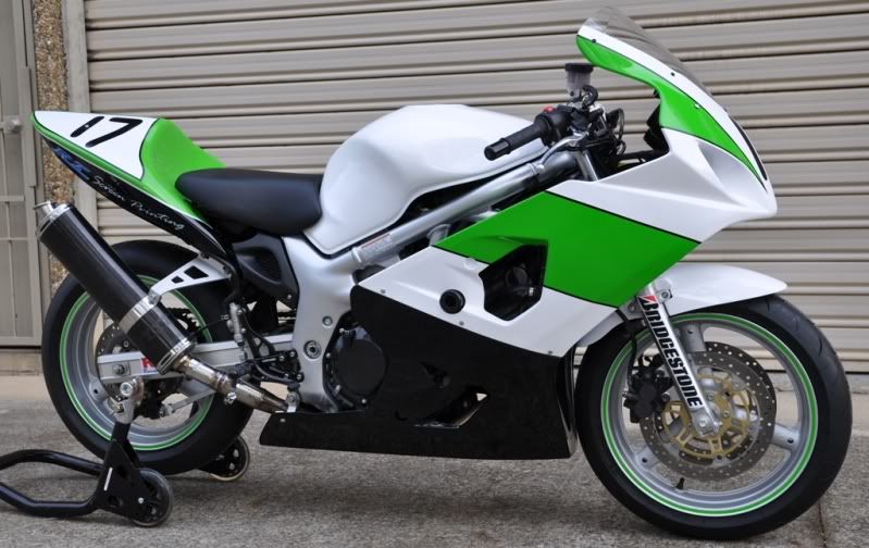

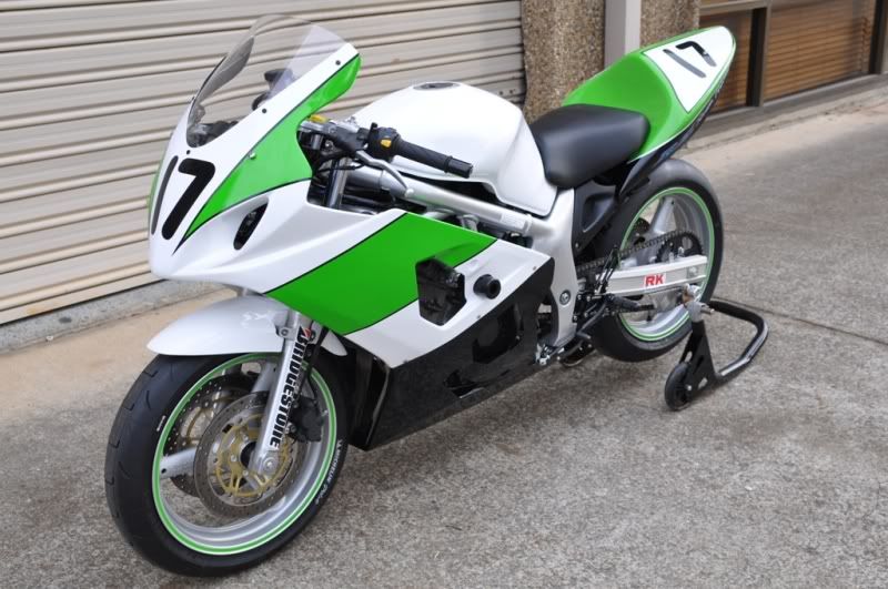

Could not bring myself to putting the road bike on the track for the odd track day so I went looking for a budget track bike & as usual my old mate Dave at motorcycle disposals came through with a bargain in the form of an 2002 SV650s with minor cosmetic damage picked up for a song.
Before I get flamed because this is not a Kwaka, I raced a 2000 model SV for 3 years so I know how they handle & what mods to do to make em go & at the end of the day It means I can still do the occasional track day without risking the 636 road bike. When we raced these they shat all over the hornets & buells & were totally kick ass in the twins class & are a heap of fun. The 2002 model is not restricted like the later models so are perfect for the track.
The budget allowed for minimal goodies mainly essentials like rearsets, pipe & fairing with the latter being optional as these are a naked bike to begin with.
Thanks to Pete at Kaneg we managed to pair up some rearsets for a ZX12R which turn out to be a perfect fit on the SV, I scored a Laser pipe off an VTR but being the LHS the pipe its upside down & after removing the end cap I discovered the internals are welded so stuff it .......for 100 bucks I am not going to complain its functional until I can afford a proper can or it grows on me, It was easy to fit with only a link to be fabricated between the original header & the can. There have never been any moulds made for SV's in Aus so I had to look for a substitute I tracked down some suitable race glass in the form of a fairing from a K4 GSXR 600 / 750 & the tail is from a ZX6R & both required extensive bracket fabrication & cutting to fit but it was worth the effort. Fairings are available from the states but the freight was going to be minimum $400 US & like I said this is a budget bike.
I am still working on her but the basics are finished & within a couple of weeks should be complete.
Tank will be getting some techspec tank grips from Mark (triway) so I will mount those first before finishing the graphics, for now she looks a bit plain & being another home painted job its not perfect but has come up pretty good.... for a Suzuki that thinks its a Kawasaki

Noice, Rob ..... what is the stock power output ?

Very nice indeedi Robstar, may not be a Kwaka but it still looks hot and I have heard they are pretty dam good track bike. Well done mate, what a ripper of a bargan. :supz: :kuda:

Nice Rob....Did Gos make the shark fin for you?

Nice job of the camouflage Rob ;)
Looks very neat indeed mate

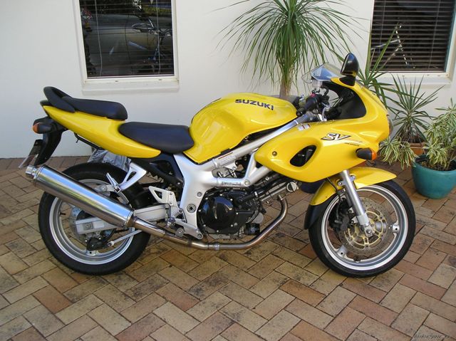

yeah used to look something like this:

Looks awesome Rob, well done. Looks way better as a full faired bike plus from a distance it will look like a Kwaka :D

ohhh congrats mate! looks very nice :D
Might needs some of these on that exhaust :D

Nice job Rob, looks great, love the colours and I don't mind the zoorst at all..........
but i'm a truck driver and a bit partial to "stacks" :lol:

nice looking bike. with the green paint scheme we shaould call it "the impersonator" :lol:
