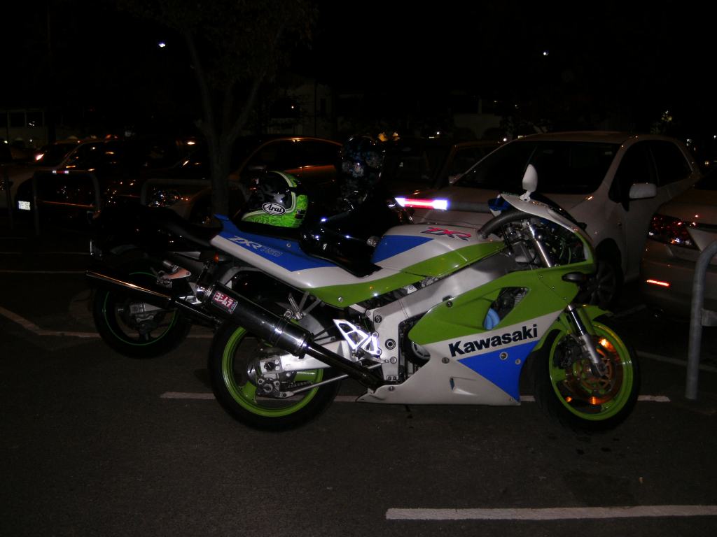

I did mine with a wire wheel and another thing that looks like a wire wheel but it's made of plastic. Go to a hardware store, it's a paint and rust removing wheel or something like that. They came up like this before paint, it was a PITA getting into some places, I used sandpaper on some of it...
I used the blue header paint, and just ran it for a while at idle to cure it and then took it for a ride, the exhaust cures it nicely. You can see the finished product here:
tag 032.jpg (103.7 KiB) Viewed 3832 times

Nice, that is exactly what i was hoping to hear. I bought the same plastic paint/rust stripper wheel from supacheap as well as a small (1.5 inch) bronze wire wheel. I already have a large bronze one (somewhere) but figured the combination of the small wheel and the plastic one ought to do the job nicely.
I had a feeling running at idle would be sufficient and that is exactly what i was planning on doing. Next step is to source a matte black or silvered high temp exhaust paint (the latter would look nicer given it's a naked bike) and organise with a neighbour to run an extension lead from the hallway next to my unit TO my garage so i can run the wheel as i don't have bloody power in my garage , and there's only so much time i'm willing to invest in using a wire brush *grumble*.
