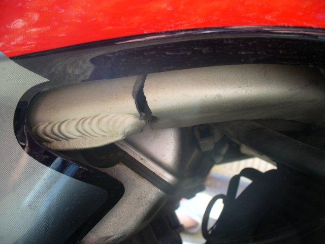

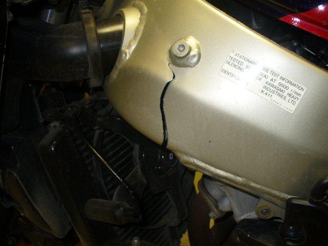

Went for a quick spin to Mornington this afternoon, on the way home I noticed what looked like a crack in the frame just under the tank on both sides.
When I got home I had a better look underneath and took these photos.
I bought this bike with 10,000 k's on it and since then have only commuted to work every day. Now done 37,000 k's. In this time I have probably lifted the front wheel twice. So I am at a loss to explain why this has happened.
Anyone know of any similar incidences?
Has there been any sort of recall on this model (2001 E2 9R)
I'll take it down to John at Mornington tomorrow and get his advice.
Left Frame.jpg (43.46 KiB) Viewed 13891 times
Right Frame.jpg (41.07 KiB) Viewed 13891 times
Not happy Jan. :cry: :cry:

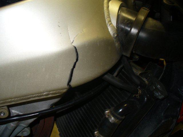

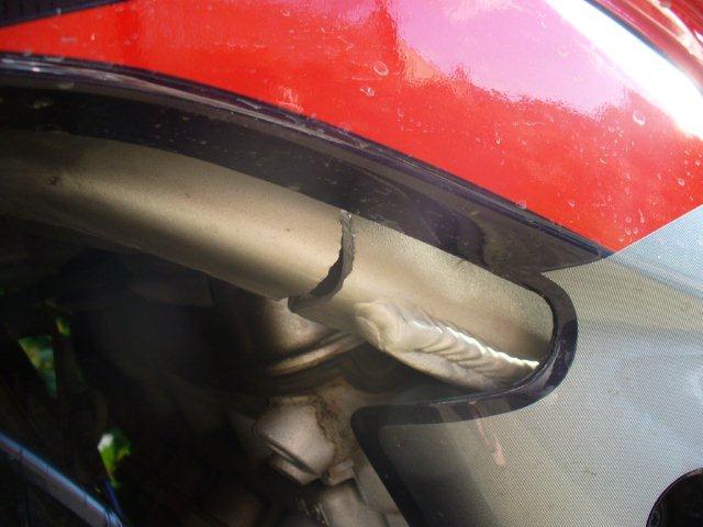

Here's a couple of pics with the fairing off.

The right side crack seems easy enough to understand, looks like a welding issue initiated the failure... the left hand side though seems to have gone in sympathy due to do the increased bending stress.
IMO that's not repairable mate.
