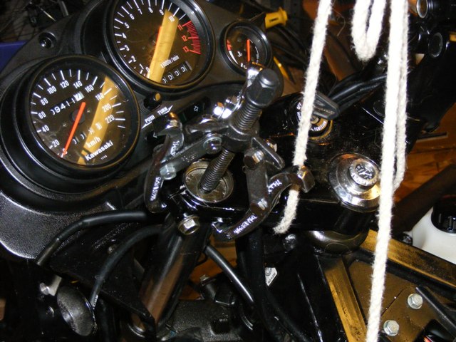

The front forks on a GPZ500 have no adjustment at all in them - apart from adjusting the pre-load via adding some washes. To do that you need to remove the handlebar raiser, fork cap then compress the fork spring (with the gear puller) enough to remove the circlip that holds it all in.

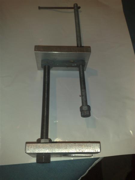

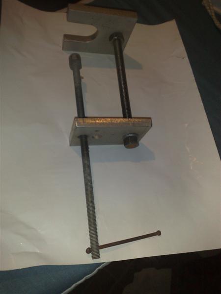

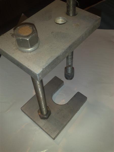

Wayne, I have a thing that will do the same as the puller. Made it for my old R65 .... same fork setup.
I'll have the bike in for tyres at Kelen's on Friday ... will bring it with me.

6maniac
Posts: 4832
Location: Hawkesbury
Re: 2 or 3 leg gear puller
Post by 6maniac »
11102010323 (Medium).jpg (27.25 KiB) Viewed 3647 times
11102010324 (Medium).jpg (27.87 KiB) Viewed 3647 times
11102010325 (Medium).jpg (30.4 KiB) Viewed 3647 times
