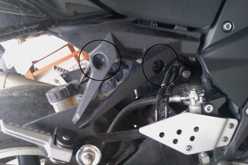

Well after a bit of a spirited commute home last night and noting that my bike didn't quite feel right I decided to have a quick look over everything to make sure it all looked OK.
Noticed that my LHS Exhaust looked a bit strange. Then noticed my plastic fairing looked to be out of place.... then noticed the reason why.
Anyone had similar experiences with loosing bits of your bike? Luckily the clamp on the linkage and the servo motor cables kept it attached.. I've now gotta source the bits from the local fastners as the local bike shop wants too much for the OEM ones.

Yes, the barge used to lose subframe bolts until i locktited them all. You need to do the same thing by the looks of it, use the blue one.

Mine was the same Duane a lot of loose bolts...And as Hoffy has suggested I lock tighted all the one's I thought would give me dramas....one tip though don't use locktight on any well nut'shoffy V2.0 wrote:Yes, the barge used to lose subframe bolts until i locktited them all. You need to do the same thing by the looks of it, use the blue one.
