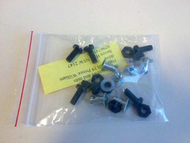

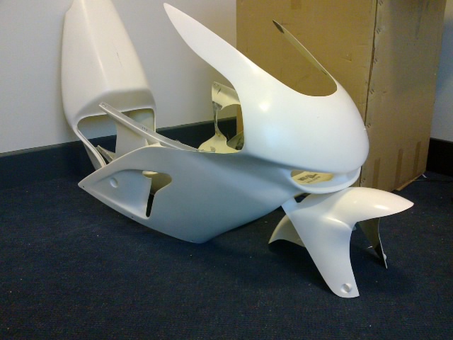

I just had my new race glass delivered to me from Wet4Uracing and I have a question....give there are no screw holes, how do I fix this to the bike?
Attached are a couple of photos. There is a bag of screws, however the tail piece doesn't appear to have any mounting points.....?
Thanks!
2007 ZX6 - Road bike
Re: How do I....?
Step 1 don't buy from WFU
Step 2 you have to do some work to fit them perfect, check & double chek then tripple check before drilling the holes, get someone to help too!
Step 3 thank god that they have fitted the Dzus clips for you, they can be fiddley at the best of times
Good Luck

You can't see little indents where the holes shoud be? When I got mine from Fibrezone they did.

Step 4, buy a fiberglass repair kit (supercheap auto etc), use a small amout on resin/hardener on the inside of the fairing around each hole after you drill. This will help prevent holes widening once in use. You will also have a nice repair kit should it be required.

Yes, I figured that's where I'll need to make holes....although the screen seems far too narrow for the top fairing piece...

I've had zero issue with Wetty, he's done more free work on my bike than i have ever paid for at any dealer.
Always willing to help at race meets at no cost...
Cheap tyres, $10 tyre changes....
As far as fitting i held mine in place with race tape then marked all the holes then drilled out with the dremel, easy done.

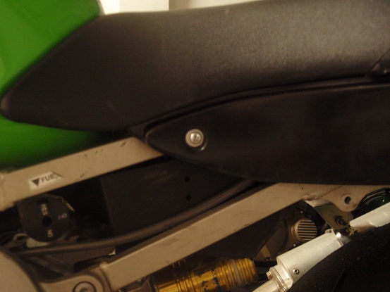

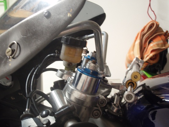

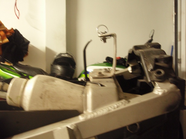

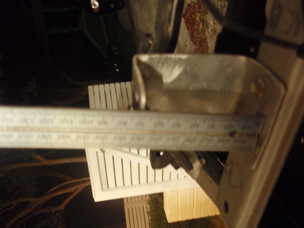

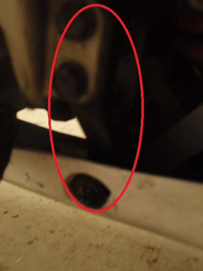

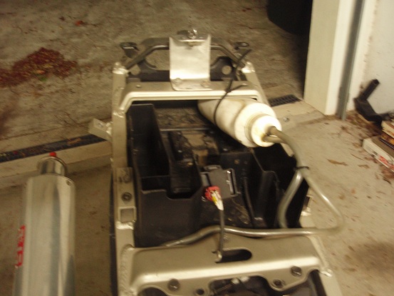

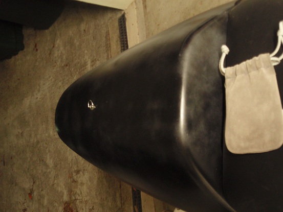

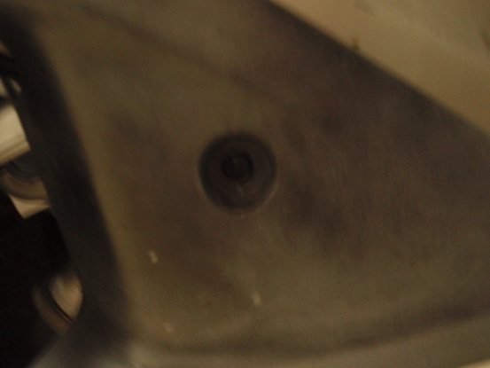

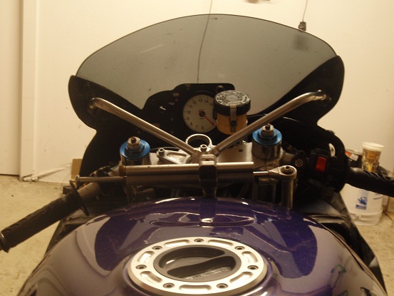

Here you go....
replacement for the H bracket, its from Harris and the arms a fixed with DZUS fasteners
side view
side view
not sure if you can see this one clearly, but this is the original bracket the holds the rear lower left of the belly pan
side view of nosecone
tail left/right
tail left/right
tail top
tail top
side view of bracket
bracket made for tail

as for looking to narrow once released from the mould......things can alter shape.. but when put to required fixings and supports on bike some resemblance to originals should appear......depending on how old and repared and or supported the original mould was when layed up :shock: :shock:
