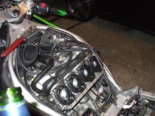

Get the tank and the airbox off..
airbox off.jpg (46.21 KiB) Viewed 1129 times

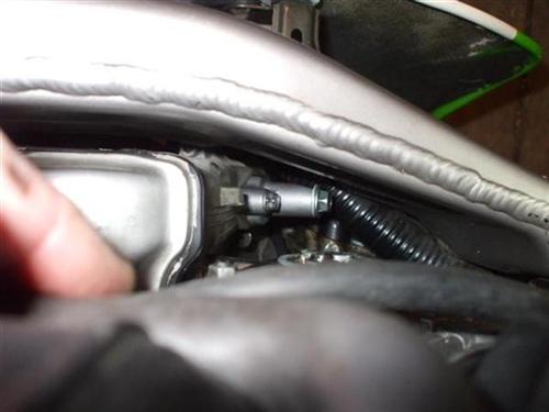

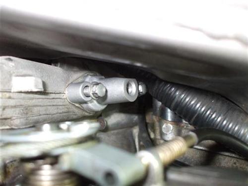

It's on the right hand side of your engine..
there it is...jpg (31.2 KiB) Viewed 1129 times

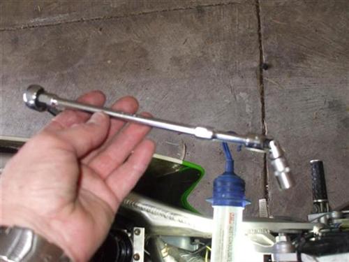

You'll need a 1/4 inch drive 10mm socket with a universal attachment
10mm socket with uni.jpg (37.05 KiB) Viewed 1129 times

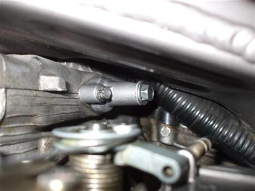

Undo the top and bottom bolts.Note; Carbs not removed..But it will make the job easier if you do..
top bolt.jpg (33.98 KiB) Viewed 1129 times

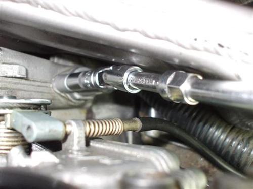

bottom bolt.jpg (33.8 KiB) Viewed 1129 times

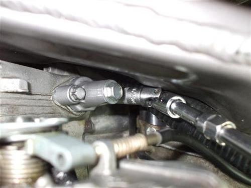

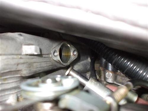

And now just ease it out... At this stage of the job DO NOT crank over your engine you will cause major damage when it fires up
out it comes.jpg (31.59 KiB) Viewed 1129 times
