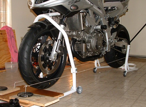

Hey Guys 'n' Gals,
What is the best method for doing a wheel alignment by myself. I am a lonely person that has no local friends that wish to help. So what options do I have?? The local bike shop (600Km round trip) is not an option. I under stand the string line method but this requires 2 people doesn't it??

I use 2 heavy Blocks to tape the string to at the front wheel.... in fact I use old bike batteries as they are the perfect height.
Re: Single Person Wheel Alignment
I use a couple of car axle stands (they are adjustable for height) at one end to tie the string to
and go from there
That tool aligns the rear wheel to the frame, fair enough but a stringline aligns "wheel" to "wheel" ........ which is the reason to do it in the first place, you want your wheels to line up ;)
Heres a rough example.... I move the batteries in & out until the string hits both edges of the back wheel the measure the gap at the front on both sides to work out which way the rear wheel has to be adjusted.

I didn't think that you could do it on race stands. Would this still work with the rear wheel in the air??
