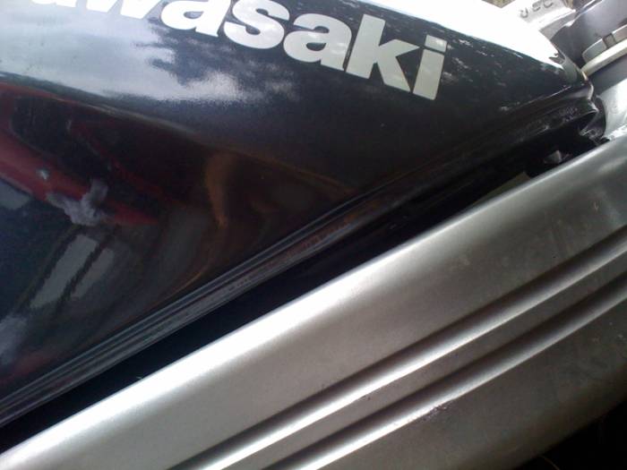

2. Is the size of gap below the fuel tank normal? is there some sort of rubber mould missing?

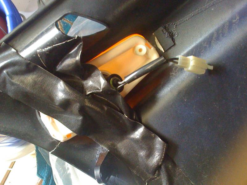

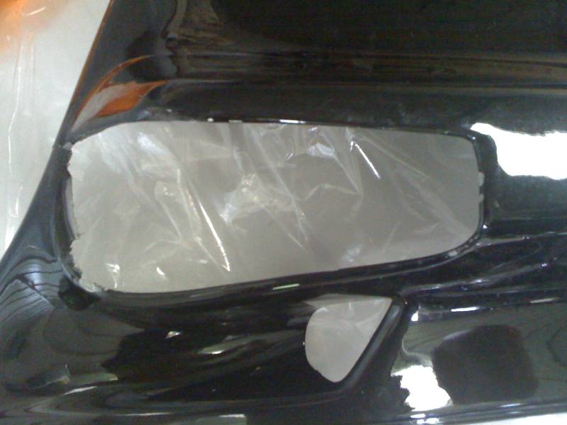

3. The front indicators dont fit into the fairings correctly. How do they fit in the original fairings? Is there any glue/sealant that I can use to keep them in permanently on these aftermarket fairings?

the tank usually has a fair gap between it and the frame from memory, althought i think it has a rubber spacer about halfway along the tank......
the indicators mount on the fairing by a hook and a screw....the hook was just a bit that sticks out of the front of the indicator and hooks onto the inner side of the fairing. the screw goes through a hole on the indicator at the back end of the indicator and a tab on the fairing, which also looks to be broken on yours......
Thanks for the reply. These fairings are missing the tab so i'll just glue in the indicators with urethane bond which is waterproof, flexible, fills gaps and dries clear. I have to use some sealant anyway because the indicator is not a perfect fit into this aftermarket fairing, so i'll need to carve out the shape with a dremel tool.

the gap between the frame and the tank is about 3-4 mm on mine. there is a short rubber spacer about 2cm long rounghly under the small k on the right side and the same distance on the left. that's how it bolts in
aftermarket fairings can be a bit of a pain. looks like the bits your indicators are meant to mount to are broken. yes, dremel the hole out carefully to the right size. my indicators sit flush with the stock fairings.
Thanks Mikk. I'm trying to make a bracket today to hold the indicator in...i'll see how it goes
