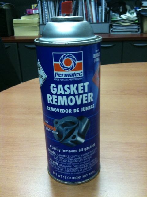

Mike that is the hard way, get a can of Permatex from supacheep spray or brush on 10 minuites later the gasket just falls off leaving a perfect surface for the new gasketmike-s wrote:clean both surfaces as much as you can using a brass tooth brush (steel is harder than aluminium, brass is a lot closer match and should minimise damage)
- IMG_0541.jpg (112.04 KiB) Viewed 862 times
- mike-s
- Posts: 6142
- Bike: Suzuki
- Location: Arncliffe, Sydney
Re: Head Gasket
Shit, i forgot i had a can of this stuff in the garage.
I'm freaking being serious!
