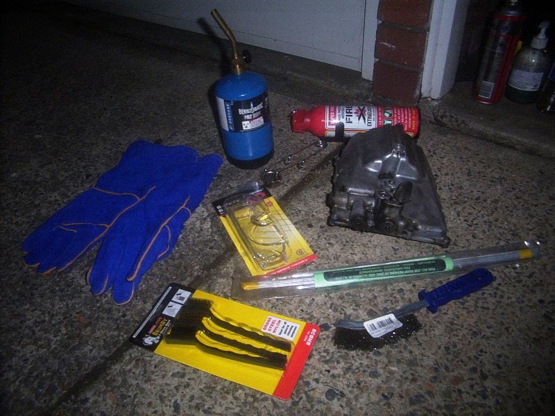

Unfortunately I haven't been able to complete doing this due to the oil pan being a right prick to remove & wasting a lot of my time tonight, but i'll put up the little that i have done thus far. One thing that isn't shown is the 2 or so hours spent getting the plastic, exhaust and radiator off to get unimpeeded access to the underside of the engine.
The basics of what's needed, propane torch and sparker, stainless steel brush (plain steel isn't any good apparently) a few small steel brushes, safety goggles, gloves (if i truely need them will depend on how good/bad i am at this, but i'll err on the side of caution for now), fire extinguisher (same again, i hope i don't cock up and set something on fire), the brazing rods & the screwed up peice of engine.

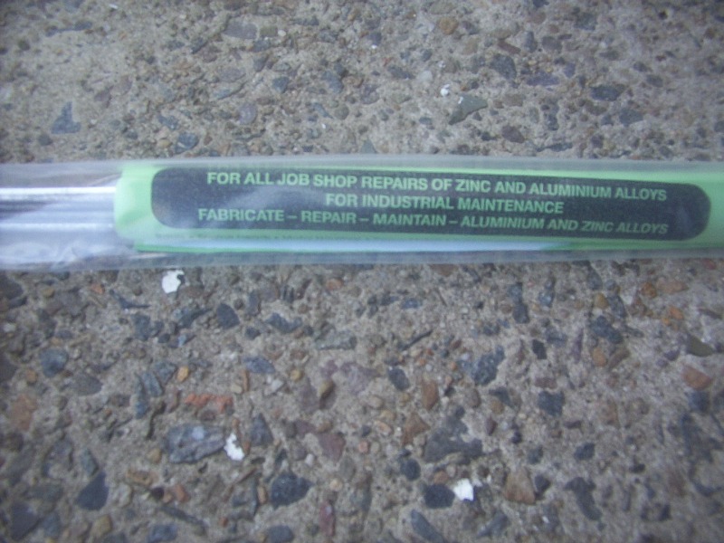

Closeup of the rods.

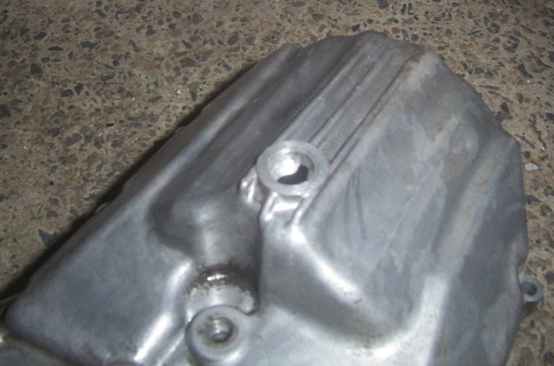

I used my crappy camera tonight, it's macro function is screwed up unfortunately. You can still kind of see the stripped thread in this picture
Next up, having a practice run and then fixing the stripped thread.

I can't remember what the first set of rods are, but i know that the second set of rods i have are a magnesium zinc & copper alloy. Apparently the zinc bit is the key to getting the rods to bond with aluminium.
