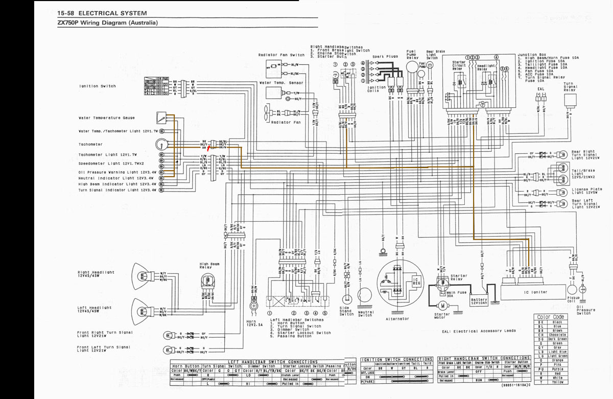

Do you have a wiring diagram? From memory, on the ZXR there's a brown wire involved in the key/ign circuit - did you fiddle with the key wires at all?

tomtom - heres the diagram.
The wire in question has been coloured. It is cut at the moment where the red line is. Perminant power to the speedo come from the white wire which I spliced near the quick release connection to the loom leading into the key ignition. Ignition (temp) power to the speedo is coming from a line that was used to power the lights in the old dash. This brown line leads into the engine stop switch as well BUT it seems to make no differance and reading the diagram there would still be power going to everything that needs it, or at least I think so.
I still have spark and when I turn the engine stop switch the bike wont even turn over. If I open the stop switch the engine still turns over as usual when started.
I can see it might be something simple and probably a result from the speedo install thus making it my fault. I'll be happy to be laughed at as long as I get the damn thing running again. :lol:
