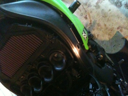

Got bored and did the Kleen Air Mod on the 'cough' trackie
Completely remove side covers, seat, fuel tank and top of the airbox.
Once u get to where the filter is, to remove the rest of the airbox its a single bolt at the top. Then on each side of the frame remove the plastic bungs (spelling?)
Using a long 3mm Allen Key you need to loosen the clamps that hold the rubbers onto the air inlets. ( not sure of that term either
The airbox should sit up reasonably easy after this!

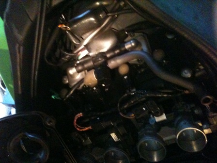

Disconnect the hose leading from the airbox down to the kleen air system (see picture its a grey hose)
Remove the kleen air module from the two air hose connections. The 2 black hoses connected to the silver plates.
Cut a length of the grey hose disconnected and connect the metal plates so they simply just are connected (ie the module now isnt connected and the air is free to pass between these plates for whatever the hell it does)
Leave the module connected to its electricals and leaving all 3 air connections open just cable tie it somewhere neatly. See pics
Now somehow you need to block the airbox plug up. I used a bit left over from the grey hose with a boat rubber bung and cable tie to secure. Hopefully this wont budge ever!!!
Replace airbox ( I found it easier to loosely connect up the clasps previously removed from underneath the rubber covering the air inlets before placing into position then tightening once in position )
Check however you secured the airbox if u did it like me that its not impeding anything.
Replace everything, turnover and happy days no more popping, no FI light and on budget
Done this on Tapatalk will try and upload some pics next...

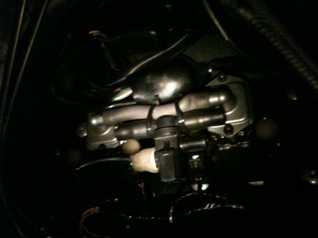

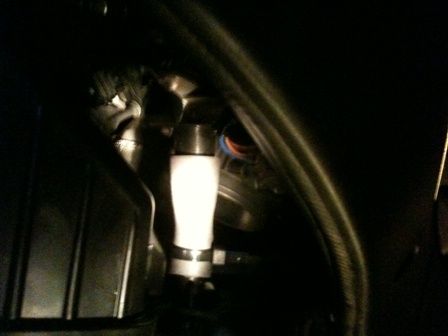

- Where you need a 3mm long allen key to reach inside to undo the clasps (See Pic 5)
- Kleen1.jpg (61.92 KiB) Viewed 6479 times
- As per factory!
- Kleen2.jpg (61.67 KiB) Viewed 6479 times

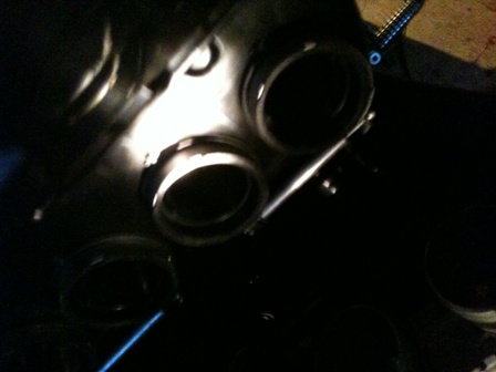

- As per mod (well what I did u can place it anywhere)
- Kleen3.jpg (43.27 KiB) Viewed 6479 times
- Blocking the airbox hole! You can use anything I had this bung around. Can use cork, or even the rubber base of a school chair :)
- Kleen4.jpg (43.76 KiB) Viewed 6479 times
- Underneath the airbox where the clasps hold the rubber down and what you need to undo to life airbox and reverse on placing it back!
- Kleen5.jpg (41.38 KiB) Viewed 6479 times
