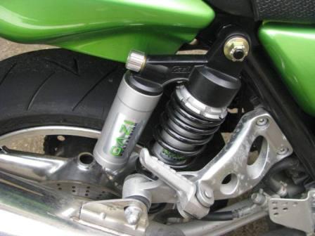

Same here the Gazi's are the ducks nuts for the money
- IMG_1508.JPG (27.33 KiB) Viewed 9655 times
