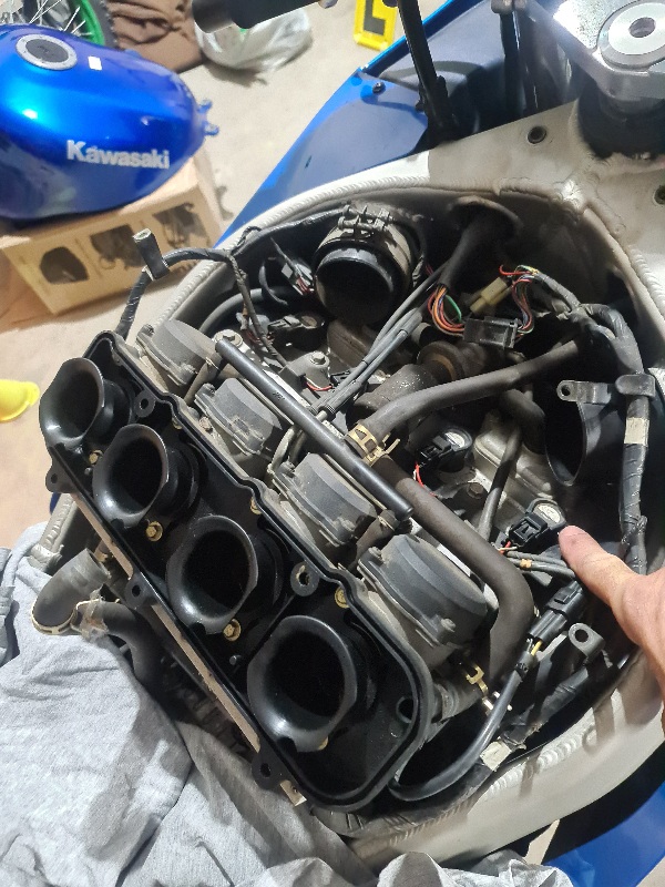

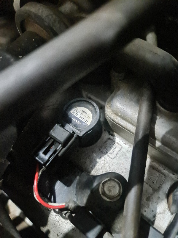

same problem here..... outside right pipe cold.
drained carby bowls, good flow, few specs came through.
Plug looked good, swapped the coils (if thats the long thing on the spark plug) with one next door, other pipe now cold, so replace coil yeah? (with Denso on it).
Should i just replace all the coils? or is 1 ok. Done nearly 1000km since i had the bike.

Hi Kiwimat. Seems like you found the issue. Whether you change all the coils is up to your finances. I would be inclined to buy one and see if that really fixes the issue and if so maybe buy another one to keep spare. At least you have a nice visible part number on the coil to search with.

Turns out it was spark plug, not coils, 4 new plugs, back on 4 cylinders, can get on with balancing carbs now.
