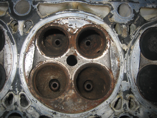

i got in contact with Allfixed but i wasnt home to receive his call on a quote to do the job i ended up asking the other mechanic to pull the head apart and he said its not repairable and i cant find a head anywhere
do these valve seals look unrepairable to you?

Re: Cheap Head Job Turns into Expensive Head Job
That head could be cleaned up & valve seats recut...... nothing hard about that!
what are they saying cant be repaired? is the head cracked?

yeah he said around the valve seals were pitted and it wouldnt be repairable do u think he under quote me $500 for a complete 16 valve job plus labour and everything else to do the job than realized it was going to cost a lot more?
Ok looking at those pics those valve seats could be cleaned and recut and ground quite easily and even if the seats are cactus any decent fitting and turning workshop will be able to remove the old seat inserts and replace, cut and grind to spec no worries, now a days only time a head is beyond repair is if it is very badly warped, even cracks can be stitched!
Don't know about the cost but he sounds like a cock head saying its unrepairable
I have had Z1100 heads in much worse condition cleaned up cut & lapped for titanium valves.

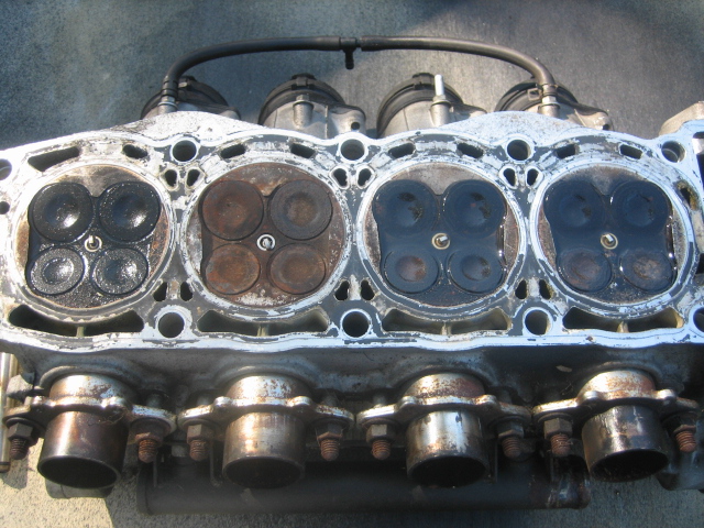

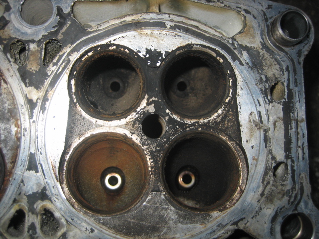

the guy at the shop said the water caused the damage to the head can anyone see that damage? the picture shows to two leaking cylinders
That head looks pretty carked to me, and in fairness, your head head bloke is pretty right in what he is saying. (It wouldn't be worth repairing or even guarantee a reasonable repair)
There are quite a few cracks, also there appears to be a fair bit of electrolysis corrosion in all the water jackets. I highlighted the areas for you to see.
You would have to be crazy to risk that casting on how deep all those areas of corrosion are, even to try welding the cracks you can see, let alone the ones you can't.
