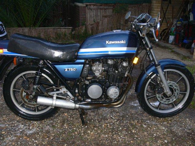

Fresh from Ebay and fresh off the trailer.
Needs.
Battery
Fork seals
Front brake reservoir
Carbs to be cleaned - runs but only just.
$800 well spent - I bloody hope. Will be RWC and Registered in the coming weeks and then the fun really begins.
Rego first then cafe racer style it....I'm in love with them things at the moment. Perhaps a more modern front end from say a ZX6, bigger swinger from a 9. minimalist look but with modern engineering.
It appears from the stories I was told from the seller and from the newer number plate that it was brought up to speed with new parts, paint etc in around 2002. Then it was parked before the current owner / seller picked it up 6 months ago but really had no interest in it because he couldn't get it to run.....He is an ebay / clearance sale junkie. So here it sits with only 60k kms and complete.
RWC and rego then rip it to bits - thats the plan :twisted:

What the hell is that link tubing on the forks?
Haven't laid a spanner on it yet but was giving it a bit of a tub today and noticed the casting and the link tube between the top of the forks. I dont see any air fitting to be able to put in 2 psi of pressure so why did they try to balance them? Or have I not found the valve yet?
Need a new front MC which ones fit straight on without altering hose lengths?
Geeze its ugly.

Re: GPZ550 82
I think these models had the stupid air-fork equalising set-up - no air was added, the balance tube was just added so that the pressure in both legs was the same ? Although, a lot of larger kwakka models around this time also had air-forks with the balance tube and a valve for adding air.......I am not 100% sure which style the little geeper had.
Get rid of that old rectangular m/c as soon as you can, boot the fuckin' thing into the bin. These were the worst m/c that Kawasaki ever fitted to a bike. You should use an early CBR600 m/c - look very similiar, same position for the banjo bolt - and work 10 times better.
Ugly is only a state of mind. Rearsets, a long tank and a solo seat can fix all that !! :lol: :lol:
