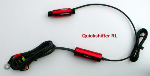

Hi all,
Well I know I said I wouldnt be adding anything else to the new track bike, but I have decided to go ahead and fit a quickshifter to the beast... Last thing.. I promise..!!! ;)
Still it will give me that extra few tenths of a second.. and I always wanted one anyway. So I have the HM model coming.. It is actually the 'Annitori' model by 'HM', which uses slightly different technology using a 'strain guage' sensor instead of the standard pressure switch.. (they are using this technology in the motoGP and moto2 bikes at the moment) It is less adjustable than the full blown 'HM' version, but as they say in the write up.. are any of us going to notice the difference between 60 and 65 milliseconds on a gear change..??
Anyway, it should be arriving inthe next few days, so I will let you know how it goes fitting etc.. But I have already downloaded the instructions and it seems very straight forward. The customer service from USA is fantastic..!!

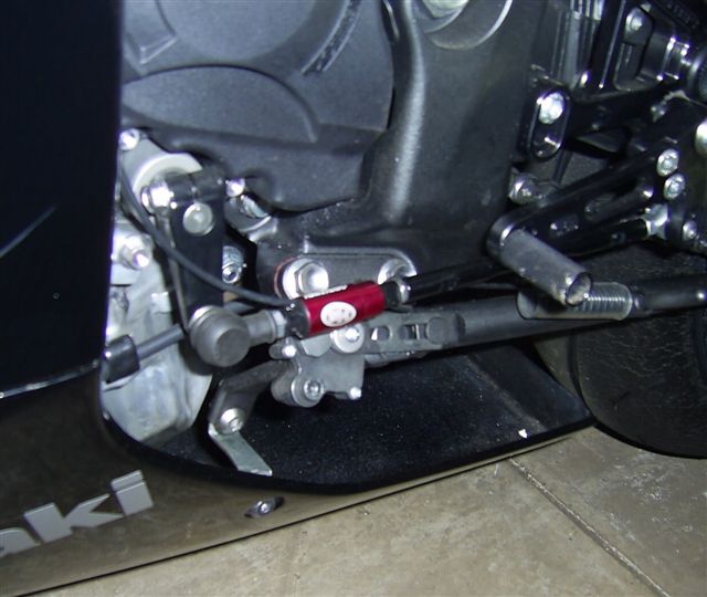

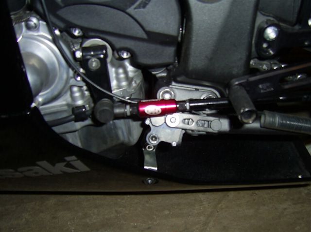

OK,
HM Annitori Quickshifter has been installed. Absoloutely 'plug and play' this set up. It took no time to instal, I probably took a bit longer just becasue I was being sure everything went off and on exactly the same, but still a very good install. Extremely neat, just the way I like things to go.
Of course everything is under the tank and seat area, not much to see really, but I have one pic that shows that it is fitted. I have done a quick stationary test, all good, but the real test comes at the Island Thursday and Friday.
