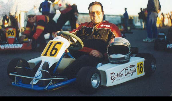

You're welcome to take mine for a test drive at any stage to give you some basis for comparison... Pic below.
Re: Go Karts
Post by laidback »
My Azzurro on the grid at WP... 8)

laidback wrote:My Azzurro on the grid at WP... 8)
Who's the young fella you had driving for you John?
Also, it's good to see Russ was looking after you with sponsorship back then.
Re: Go Karts
Post by laidback »
See what knowing youse all does to a guy...turns you old... :twisted:
Was the guy from Goulburn...Rob Ferraro or something like that...
