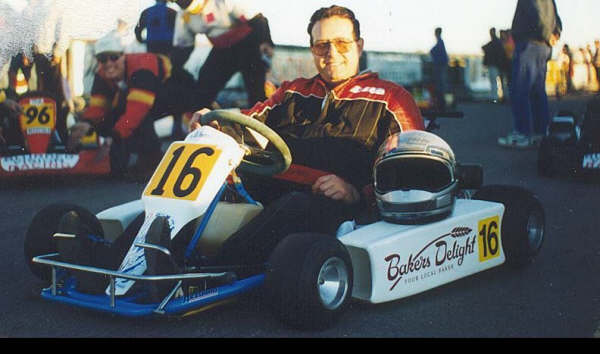

My Azzurro on the grid at WP... 8)

laidback wrote:My Azzurro on the grid at WP... 8)
Who's the young fella you had driving for you John?
Also, it's good to see Russ was looking after you with sponsorship back then.
See what knowing youse all does to a guy...turns you old... :twisted:
Was the guy from Goulburn...Rob Ferraro or something like that...
