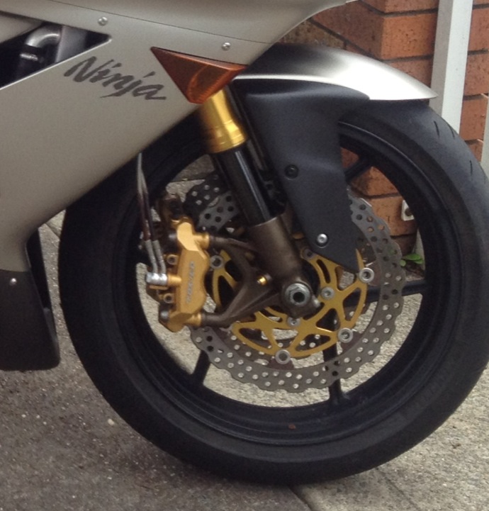

Just another question, each brake caliper has 2 braided lines running to it? Is there any reason for that
- born green
- Posts: 1491
- Joined: Sun Aug 07, 2011 6:59 am
- Location: blind bight vic
Re: Braided Lines
Not sure what u mean by two lines?myzx10r wrote:Just another question, each brake caliper has 2 braided lines running to it? Is there any reason for that
Form new, they run one line from the M/C down to the right cailper, than another line over the gaurd to the left cailper.
When u replace them, ask for the (race patern) as in just two lines. From the M/C u will get only two lines, one goes to the right cailper, the other to the left cailper, no balance line from the right cailper the the left one.

Re: Braided Lines

That makes two of usmyzx10r wrote:Ive checked and double checked.id post a pic but i dont know how too?
when u decide to get them, be it over the net, or from a bike shop, the prefered choice is two seperate lines, they will come with the longer bolt for the M/C, so u should'nt need to buy any other bits.

Re: Braided Lines
Hi Guys,
Photo added. Easy and i knew how to do it. Much easier than other sites.
As you can see, there are 2 lines going to the caliper rather than 1 (as on other models) and you can see at the bottom, they looked rusted or have leaked. Is it normal that each caliper has 2 lines?
- Front Caliper.JPG (121.62 KiB) Viewed 6596 times
