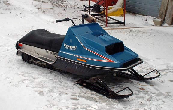

Sounds like carb icing ...
Maybe this would be more appropriate

Snowmobiles are a lot of fun. Unfortunately we have just enough snow to screw up the roads but not enough to use a snowmobile, even at 10,000 feet altitude. Jim time. Cheers!!
