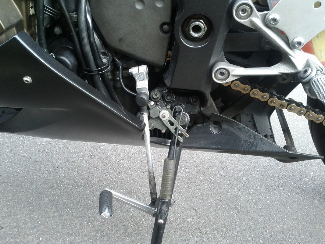

My shift linkage bolt that connects the linkage to the rear set sheared off today on the way to uni. Does anyone know where I can get a replacement bolt quick?
Bike is an 05 ZX-6R.
Heres a Picture if it helps. Thanks

Well the bolt that goes through the shift lever at the pivot point sheared off at the thread, so everything is fine except I have to get the remaining bolt out of the rear set and just replace the bolt... hopefully.
I will give metro spares a ring and if they don't have it I guess Ill talk to someone kelens. Thanks Maddog.
Also anyone have pointers for removing the sheared off bolt?

An "easy out" will do it,MartyPans wrote:Well the bolt that goes through the shift lever at the pivot point sheared off at the thread, so everything is fine except I have to get the remaining bolt out of the rear set and just replace the bolt... hopefully.
Bunnings may have em, but a good engineering shop will for sure, something like Glenwoods or Buttsworth or any AIS shop etc...
Thats my tip. Good luck.

An "easy out" will definately get it out as Chitchats has recommended..
If you are going to use the wreckers option just tell em your'e after the shiftrod aswell...Wouldn't think it would cost too much extra.

Thanks guys, got the thread out of the rear set and found a replacement bolt at Sliverwater wreckers.

If you can get a left hand thread drill bit as well it's handy .... you may find in drilling the hole for the easy out you actually loosen the bolt with the drill bitChitchats wrote:
An "easy out" will do it,![]()
obviously only use a drill you can reverse the direction of
