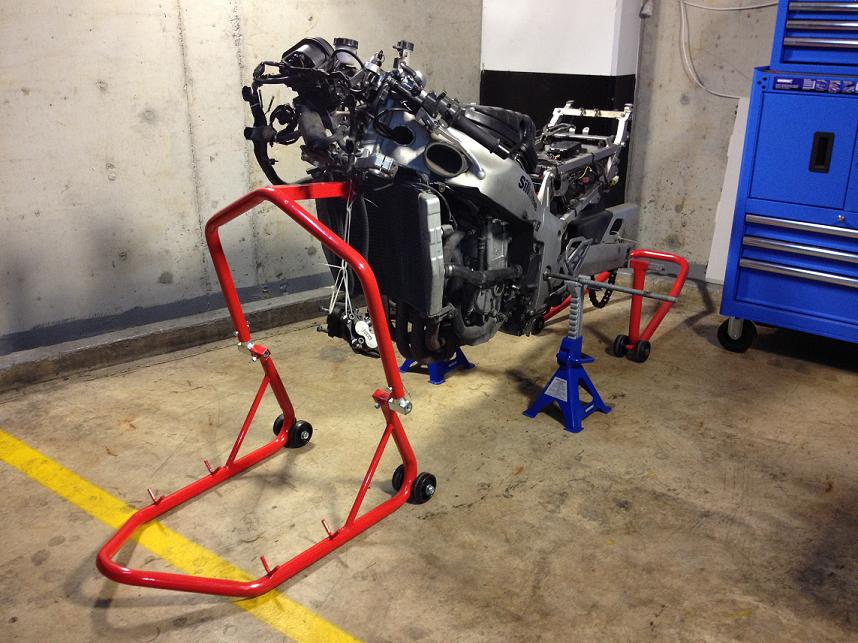

So the track bike is coming along nicely; though you wouldn't know to look at it :shock:
- Fairings are being made and should be delivered next week ready for paint
- Suspension is away being fettled, 3 or 4 weeks to get it all back
- Michellin Power One's are on the wheels
- New pads have arrived
- Rearsets on their way from UK
- Fairing/tacho bracket on it's way from USA
- R1 Quick throttle fitted
- Unused electrical switches removed
- K&N in airbox
- Engine serviced
Need to order braided brake lines from Hel today or next week, bolt everything on as it arrives then we shoudl be good to go :kuda:
Small IMG_0271.JPG (107.83 KiB) Viewed 7677 times
