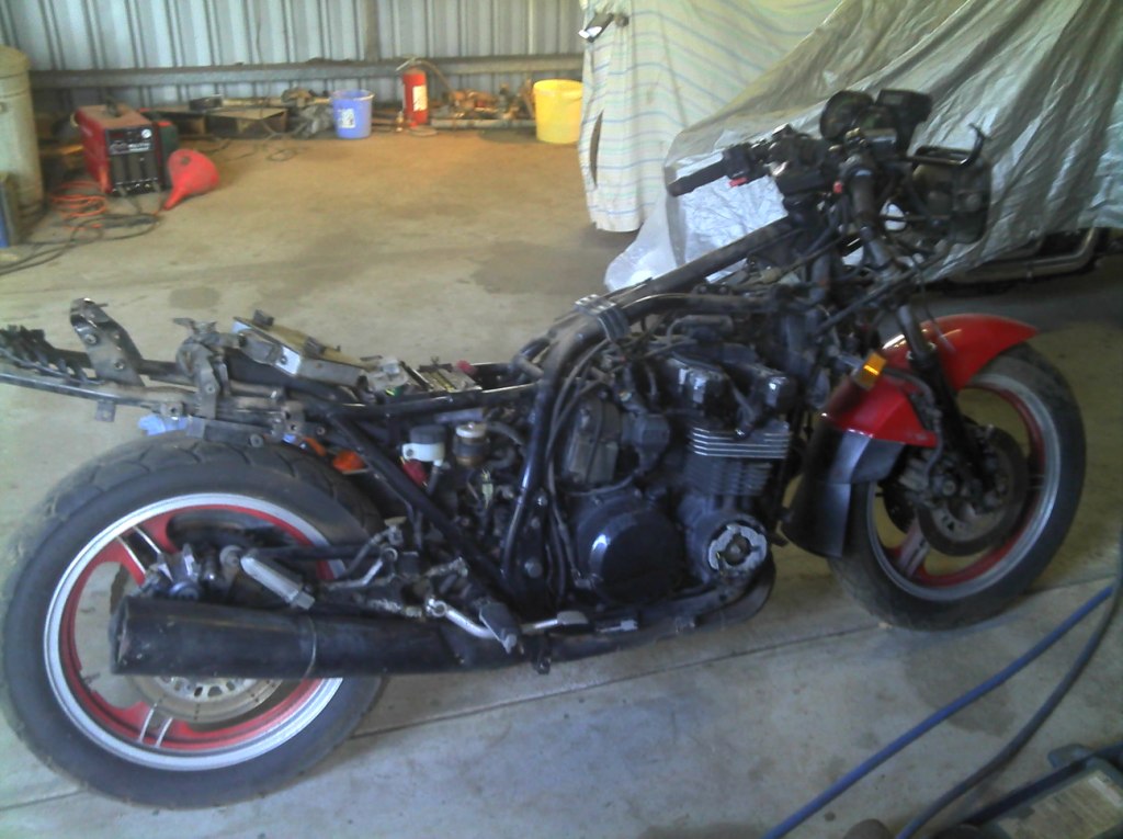

Gents, its been some time and I am on the bludge.
The Turbo I started around 12 months ago has been fully rebuilt and does not look too bad.
I am usually on the turo.com forum but have a problem that some of you may be able to help with.
During the rebuild I replaced the starter clutch with a new kit as the clutch had been slipping intermittently when she was on the road some 16 years ago.
Now with the rebuild complete the clutch was still slipping more often than before. I put that down to better compression.
I decided to pull the sump etc off again and get to the bottom of the problem so after inspecting the components of the clutch and secondary shaft (bearings etc) and finding nothing obviously wrong, I bought a new starter sprocket and reassembled the whole thing. First try at starting and the bastard slips at least as bad as before. Strip the thing down again and washed all parts and reassembled dry. (I was clutching at straws and thought maybe oil type was the problem) Reassembled once more and had no slipping problems at all.........until I refilled with a standard mineral based oil and now the clutch is slipping most of the time.
I am hoping some of you guys will have heard of the problem and am open to any suggestions.
Photo of (almost) completed rebuild below

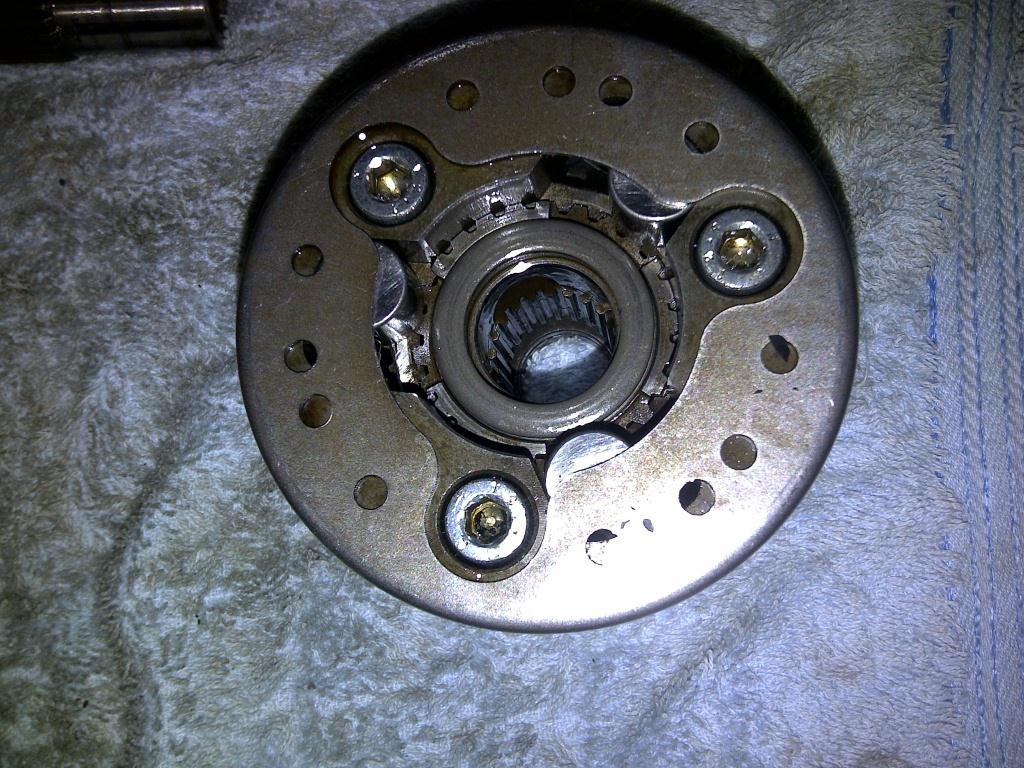

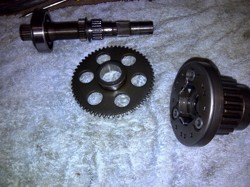

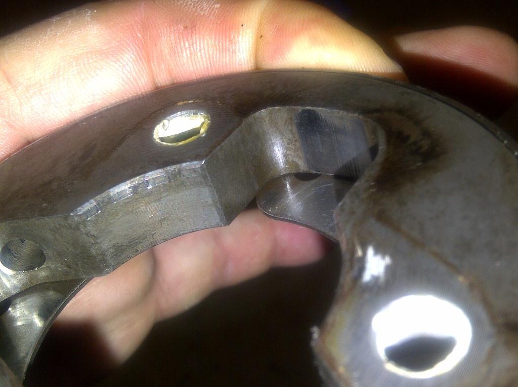

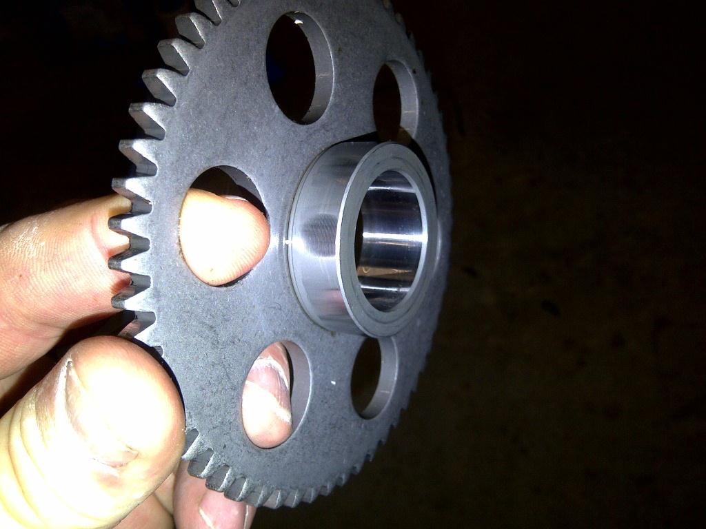

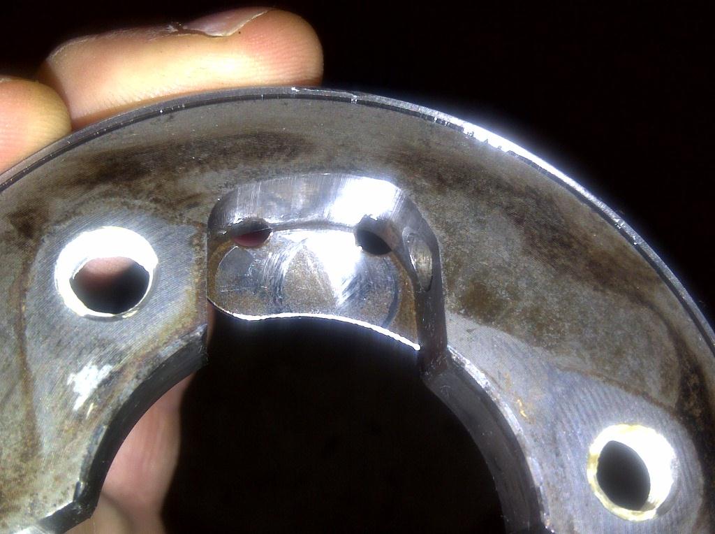

Thanks Gos. I stripper her down again last night and had a good look at the clutch hub and it may be that it is the problem so to eliminate that I have ordered a new one, $170, but better than having to strip again, hopefully.
That will be all components that contact each other will have been replaced and if that does not work, well.........
Clutch hub and sprocket pics below.
Will let you know how it goes,
Cheers.
Cheers.
