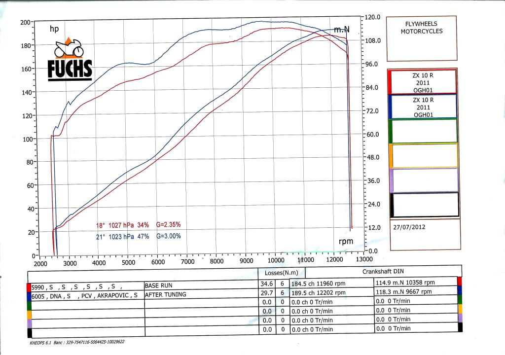

Well it's done. Power Commander V plus Akra shortly and link pipe. DNA filter, Servo Buddy and O2 Optimser. Only picked it up Friday and haven't had a chance to really try it out but for a street bike around town, the sound is awesome - almost embarassing!
Horespower gain is the expected average of 5 although its's twice that in the mid range. What the tuner was impressed with was the gain in torque between 3,000 and 10,000 rpm. I've attached the dyno charts and look forward to your interpretations and comments. How do these compare with other results?
- scan0002.jpg (113.95 KiB) Viewed 8175 times

Nice curve it's good to see the wavy power curve is there just like the Gen 3's. That is a very happy number Dyno
To do the tuning per gear takes alot longer it's only a pain for the tuner if the customer doesn't want to pay. Also most Jap bike's are a pain now days due to Closed loop AFR feedback, Secondary injectors, dual rev range injectors (RSV4), variable power maps etc. it all just takes a bit longer to tune.

That dyno chart does look good
very healthy HP, u got to be happy with that.
I got mine custom mapped, not cheap, and does take some time to do, bike used a tank and a bit of fuel to do, so it did spend some time to do, but it runs and pulls real good.

Does it mono good? If not take back to tuner & fix!valkau wrote: How do these compare with other results?
That dip in torque @ 5-7 & 9-8k are they flat spots due to fueling and or timing?
You wouldn't probably wont feel that @ WOT, did they give you a print out of the AFR's (air-fuel-ratio)?
That's the better way of doing it and more applicable for road use, unless you plan on sticking in 4th or 5th gear @ WOT.pittster wrote: To do the tuning per gear takes alot longer it's only a pain for the tuner if the customer doesn't want to pay.
Re: 2011 ZX10R - Latest PCV/Akra Shorty Tuning
Flat spots are apparently due to pressure changes arising from the altered plumbing. The factory system manages this through the servo to even it out better. I'm using the stock headers with the link pipe and shorty and there's no management system for the pressure. A larger can would also change the outcome because it will change the length of the pipe. I understand the race headers are larger diameter and exaggerate the dips even more but race pros know how to manually compensate (I'm told).
The tuner felt that the PCV software was not on top of the latest ZX10R electronics as others have already indicated above. Forget about a standard fix straight from the box - it's individual crafting but worth it if you are patient. Ron at Flywheels knew it would be tricky and had the bike for 10 days so he wasn't under any pressure. It cost about $1,100 all up for PCV, O2 Optimser, Servo Buddy, DNA filter and tuning but it seems to be well worth it based on your comments. I think he's done well and was experienced enough to know it would be a demanding job.

I agree. Ron's very understated but know his stuff. I'll set out further details of the tuning tomorrow. He says the trick is to buy a genuine locally supplied PCV becasue the imported units always seem to be trouble - even if they're mean't to be thr right spec for Oz.

If my tuner was to comment, I'm sure this is what he'd say:
I was more than pleased enough with the improvement the one custom map had on the overall performance.
After I got the map right, I ran it in each gear and the a/f ratio looked good. Yours had a great result. Everything I did made a difference... cylinder trim, accelerator pump, 02 optimiser adjustment. It was very responsive.
I know bragging rights are sought after with gear tuning, but as mentioned before, we were able to get a big improvement from the custom map and tuning, and if you are happy with the way the bike performs then you are ahead. I have had people try and buy the PCV cheaper on Ebay (from the States) and no matter how much I adjust the map, there is no effect at all.
Individual gear mapping is only suitable for racers who have all the PC accessories for further performance like the secondary fuel module and the ignition module.
These two add-ons require some serious “gear-dependant” tuning. With the quick shifter too. And in the end, the benefit is an extra 4 horsepower (quoted by PC importers themselves). It’s an expensive task but 4 horsepower is a lot for a racer.
There is also an auto-tune module and a quickshift expansion module. I have found in the past thought, that overloading the poor little bikes with 4 add-on modules, never works in the favour of the customer. There are always complications with the sensitive circuitry and it is difficult to isolate the issue. Often when one of them fails, it causes the others to fail. Also in the past we have seen, particularly on the ZX10R, that the power commander and its add-ons can interfere with the stock ECU to the point of failure. Then you have big issues.

Yeah Macca thats what i am thinking, Only going to get the mapping done to sort out anything the link pipe might do the fuel system. Simple PCV and 02 optimizer should be heaps for road and most track for me anyway.
I would be interested Valkau to see how your map ended up looking compared to what PC supply themselves for this setup, have you got the map and run it up in the software to see the + and - fuel adjustments ?

I agree about the power. My use is mostly road with occasional track so this has been totally indulgent - mostly following a dare by Madkaw at World Superbikes. The sound and the look without the cat box was the real objective and as Ron said, be happy with quite a surprisingly good outcome with standard PCV mapping (and a good tuner). I'm having a good look at the maps with him this week.
