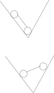

Plenty of steep down hill and up hill action on the weekend.. A few "you've got to be shitting me" moments all good though. What brought me unstuck was a really steep ravine.. downhill, then straight up. The bike came to a sudden stop at the bottom and off i came. Definately learning to lift the front would have helped and im working on it, but i want to know how should it be done? I cant seem to find anything specific on riding terrain like this. Any ideas?

Yes im basic :roll: This is what i did.. - the second pic im guessing i should do by lifting the front before i get to the bottom? is this correct?

Assuming steep incline going in and just as steep going out :shock: + beginner :?
Going down
1 go slow
2get your body position right: bum as far back as possible
3arms out stretched BUT not locked straitght. you need some give in them, just like shocks
4 go slower, as slow as possible, using rear brake . Dont worry if you lock the the rear a bit, just ease of to keep forward motion.
5 front brake only if confident. Usually leads to locked front wheel and the front washing out.
6 get the bike into the lowest gear possible, depending on speed and incline, you need a fair range of revs to be able climb as far out before running out of revs and needing to change up
Across and up
1.for a beginner, If possible have the bike come almost to a stop, or very slow crawl, as the front tyre nears the other side, obviously this will depend on balance etc
2.at this point you either bounce the front to get the weight off and the front tyre up, or allow the tyre to roll up the incline WITHOUT loading up the front suspension.
this is where most of the problems occur. The front hits the other side at speed the front suspension dives loads up and springs back. knocking you off balance.
3 apply power, generally lots of it !
4 as you apply power you need to pull your self as far forward as possible, get your head over the handle bars, as you need your weight to keep the front end down
5 dont wory about wheel spin, you adjust your weight back to get grip if needed.
Better this than all the weight back and the bike flipping
6 as you start to climb, adjust revs / wheel spin to ensur you keep forward momentum. Sometimes you may need to wheel spin all the way up, depending on the ground.
sounds easy, but it is a hard one to get. but once you get it, it does become easier and you can do it with more speed. ;)
hope this helps

YAY Did all that... may have been a touch faster than i should, but was still in control
RustyAs wrote: Across and up
2.at this point you either bounce the front to get the weight off and the front tyre up, or allow the tyre to roll up the incline WITHOUT loading up the front suspension.this is where most of the problems occur. The front hits the other side at speed the front suspension dives loads up and springs back. knocking you off balance.
Ooo Yup this where I came unstuck. Balance and the kick back would explain how i ended up a bit further away from the bike than just a drop. There was no chance to let the front roll up, so maybe i should have tried to bounce it. Its freaking daunting :shock: but i'll give it a crack .. the worst that can happen is coming off.. and thats over rated :roll: :lol:
RustyAs wrote: 3 apply power, generally lots of it !
hope this helps
Rusty :kuda:
Thanks! that helps heaps!.. :kuda:
I dont have any issues going up or going down, it just the bit at the bottom on such a steep incline.
Awesome thanks.. More practice YAY :twisted:

Learn to sip the clutch and pop the front wheel up, then learn to do it standing up and you will eat these obstacles up for breakfast. :kuda:

Thanks Nelso.. I would luv nothing more to master this skill.. the little XR doesnt have the power "just to pop it" so any help im open ears!

Post by Nelso »
