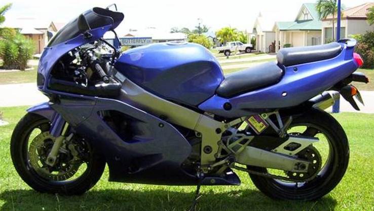

I picked up a 94 ZXR 750 bike last week, Needs a a good tidy up but I will have fund rebuilding it
Not going to bother repairing the fairing so it will be a stripped down street fighter, I have removed heaps of odds & ends, I wont be using the speedo, Headlights & all the mounting brackets so if anyone needs them PM me
This is what it looked like when the last owner bought, Sadly it looked much worse when I got it
This is what it looked like when the last owner bought it
ZXR 750 FIGHTER BUILD.jpeg (50.58 KiB) Viewed 9553 times

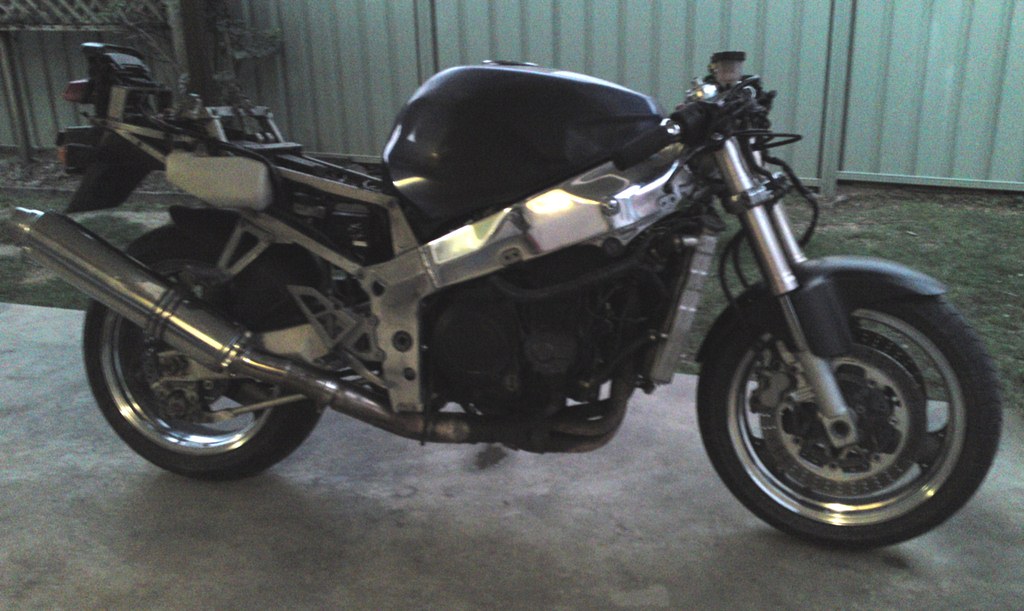

Slowly getting there

Lots of new goodies>
The DYNA coils & leads made a big difference
The FLY SNO X (20 degree) bars really tidied up the look & feels much better than the MX bars I had
A ZX7RR / ZX750N shock should make the back end a bit smoother & tidier
ZX7 forks, Lower triple clamp, Guard n calipers fitted after I polished the lower sections of the forks
Damn nice reservoir from Germany, I will get the clutch & rear brake reservoir soon

Will be good when I can get some pics completed with the tank & tail on

Thanks to the pic of the solenoid wiring you posted (Thanks heaps for that Jim) my bike is running again, It turns the starter much faster now with the new battery, solenoid & wiring tidied up
ZX7 shock in a ZXR 750, I could slide in a ZX10 or similar shock if I wanted to now
I found a new fuel tap for $20 so I bought it just for the hell of it because they are probably about $100+ in Australia
