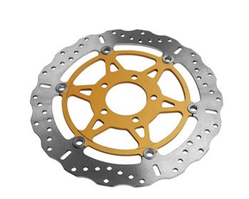

I have recently fitted EBC XC rotors with HH pads and had no problems and happy with them.Around $500 for the lot at the time Rockymountain. $210 each rotor.
- ebc XC rotors.JPG (22.2 KiB) Viewed 2463 times
