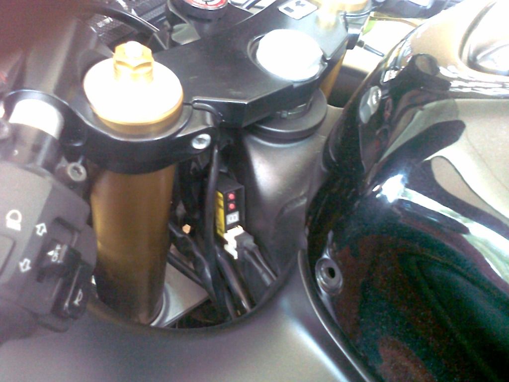

Hi mate,i run a straight steel front sprocket and "to me" feel no difference at all with the vib area,i run a 190/55 rear tire (taller than the standed) and have droped my front end 6mm's..the bike steer's a lot sharper than standed,i don't run a steering damper but i do have lighter than standed wheels on her.

- MAXUMIS
- Posts: 1034
- Joined: Fri Jul 09, 2010 7:16 pm
- Bike: ZX12R
Re: My new 04 ZX12R
6mm's of gold showing through the top clap,not including the srew on/silver bit,i will try find a pic.
