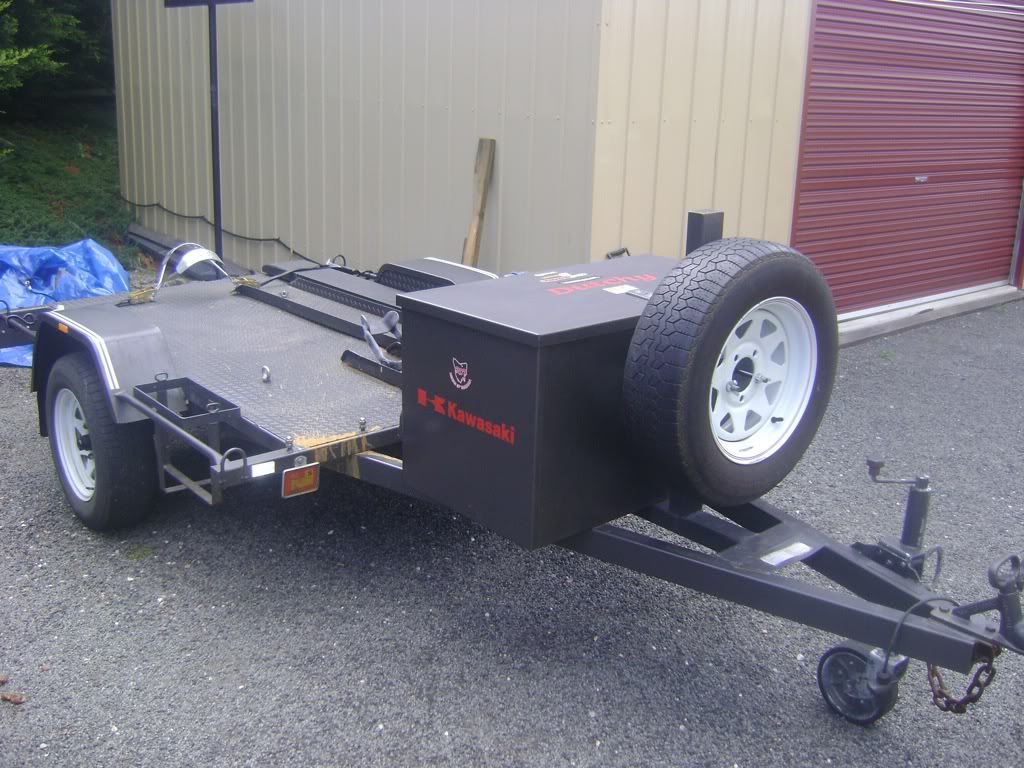

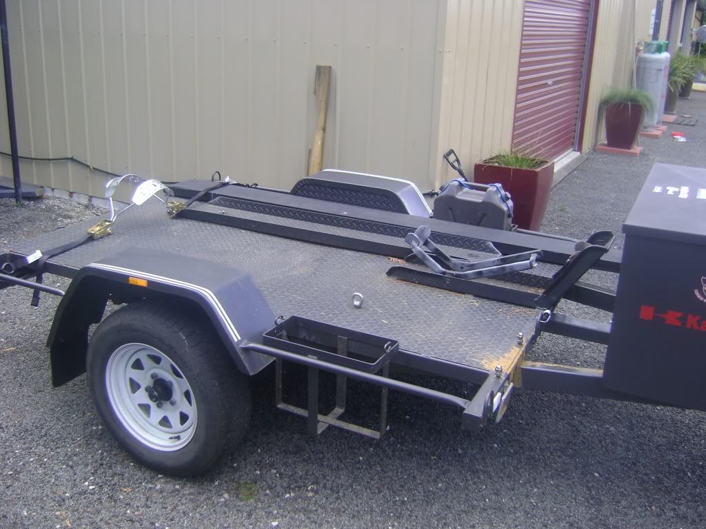

Here some photo's of my trailer set up.
Cya Dutchy

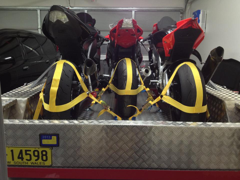

Yeah best way to anchor the bikes down at the rear, me and my mates picked up the strap style ones from aldi when they were $30 each. Bikes dont even move and inch with these and front wheel clamps.

SNAFU wrote:Here some photo's of my trailer set up.Cya Dutchy
The rear points Nice n close, just a pity they are right at the back....... should be a winner anyway!
The strap one I have has a wrap around section in the middle that attaches to the tyre..... step up from the aldi ones :D

I just use a front tie down with minimal compression and the rear tyre down. You really need those anchor points close to the rear wheel though mate. From memory the instructions say to have the mounting points 80cm- 1m apart max and slightly forward of the rear axle. All i did was put the bike one the trailer and marked 40cm from either side of the tyre and about 10cm forward of the axle. If you have them the way it's setup in the picture it's not going to work very well. Also, make sure when using it that the two metal plates are at the "10 and 2" positions on the tyre. I made the mistake of having them at "9 & 12" once and by the time I got home the entire thing had fallen off and the bike was being held by the front straps only
