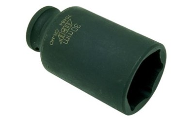

Definitely don't have one of them on my 9 and I would stay away from the square section when you're trying to loosen it, unless you want to shear the sucker off that is. Looks like you need one of those 6-point deep impact sockets. I bought one from repco for about $30 to remove the drive shaft lock nuts off the car to replace them. I always use a big piece of timber through the rear wheel and against the swingarm like Gos said and breaker bar. Makes a lovely big cracking sound when it finally lets go too and for a split second I always think I've broken something.
This is the socket I use.

Kev wrote:Definitely don't have one of them on my 9 and I would stay away from the square section when you're trying to loosen it, unless you want to shear the sucker off that is. Looks like you need one of those 6-point deep impact sockets. I bought one from repco for about $30 to remove the drive shaft lock nuts off the car to replace them. I always use a big piece of timber through the rear wheel and against the swingarm like Gos said and breaker bar. Makes a lovely big cracking sound when it finally lets go too and for a split second I always think I've broken something.
Yep that's the socket.
27mm socket on most.
I did Hoffy's the other week. And even with a shithot electric rattle gun, it took a good 5 seconds before the nut started turning.

Don't try to use the square section, whatever you do. It'll just collapse and stuff the nut completely. The bit I could never understand is why the hex section has rounded corners from new.

Yep, all the above in particular the deep socket Kev posted..

Re: ZX9 front sprocket removal
Look for Kinchrome 4wd hub sockets in stores like auto pro. There's a few different sizes and they're just like the one in the picture.laidback wrote:
