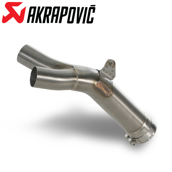

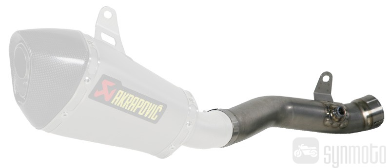

What's the difference between these 2, both from bike strore websites for the 2011/2012 ZX10R with Akrapovic Slip on
from what i can see the one with the single pipe only seems to have a spot for a sensor where the other doesn't.
I take it i will have to get a power commander also to richen up the fuelling when the cat is removed,
anyone else done this to their 11/12 ZX10R

I think the second one is using a generic akro pipe picture.
Your bike only has one pipe.i reckon that other one is for an R1 or something

Ah, so Sportbike TrackGear are just being lazy, all the link pipes should come with the sensor hole right?
Did you do this to yours wattie? If so difference in sound and torque?

Nah not mine.
Not all link pipes come with the bung for tuning.
You'd think all akra ones would. But best as the question to the supplier.

There may be 2 types of link pipe for the 10 from Acro as the USA don't run a O2 sensor in there system. I found out the hard way with a Yoshi system I took delivery of yesterday. Had to track down a adapter, pop a whole and weld it in.
Just in case you need to know the adapter is a M12 with a 1.25 thread pitch.
