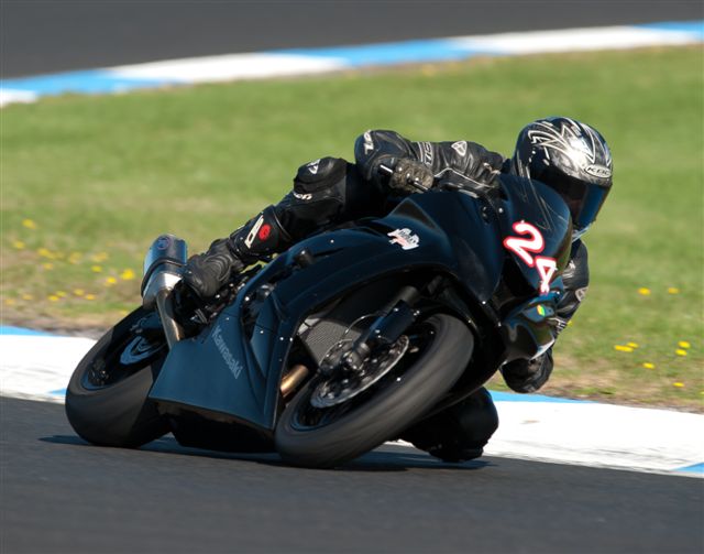

Re: New 2013 ZX10R
Wow.. 11mm of tube showing above the triple clamp... thats huge..!!
But they have not mentioned anything about raising the rear ride height, so that would explain the huge amount.. I did have a mate drop his 5mm through, but we adjusted the rear slightly to make it work... personally I dont want to go any lower as the fairings would end up touching the track if I lowered the front any.. in fact I did touch down in the last race I was in.. so not much clearance there as you can see by this pic...!!
Also these settings are pretty general.. it all depends on your weight and your ride style.. as in how late and hard you are breaking etc.. My settings are totally different to this but I only weigh 72 kilos...
Macca

I guess the other thing is I'm not goin as fast as you blokes on the track. If I did track it I might notice a bit more twitch from the front but on my normal road loop it really feels great. Nice pic by the way.
